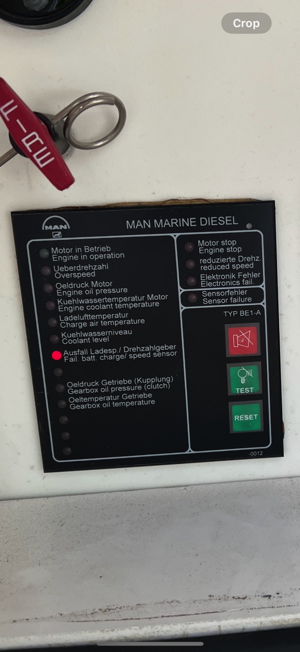

    I have 2001 man D2848 LE 403 engines all mechanical with the older style alarm lights buzzer screen pictured below. I see where they are plugged into the back of the screen/ display whatever it is actually called.
    On the port engine all of the lights and when a warning has happened the buzzer sounds and the light flashes etc. However when running sometimes the GREEN engine in operation mode light will be on for a while then off for a while. More so off at 1900-1950 rpm's. But certainly it is intermittently operational.
    I have check the connection to the back and made sure all was good, does this unit plug into the big black boxes in the engine room, or where else do I need to check and see what is going on along the line, I assume it to be a bad ground/loose connection somewhere.
    Any input is appreciated, thank you

    It could be as simple as a fault with the LED or it's connection. Can you switch the port and starboard indicator panels to localize the fault to the panel itself (or not)?
    Also, when checking plugin connectors, pay particular attention to the pins and receptacle sleeves IN the connectors. I have found faults where the locking tab on connectors were not fully engaged and the pins or sleeves were pushed back and making a poor connection from manufacture. Problems with the connections appeared later in life after vibration or tarnish affected the quality of the contact.
    I'm with you; small innocuous failures can be the precursor to larger problems, like the engine actually being no longer in operation when the light goes out!

    The green light will be out for good 15 minutes sometimes while running at cruise 18k-1950 ish then will come back on for a while, then out for half hour or so etc. I will definitely check the connections again at the helm.
    So the engine is in operation, I was also worried that if that light was out is that particular green engine in operation light a "master power" on so to say for the entire panel. Like if that light is out is the panel not going to show any other alarms.
    Answer to that is no, yesterday I had a coolant level sensor failure alarm go off while the "engine in operation" light was out. So that tells me the engine in operation is isolated from others in panel, at least for the coolant level sensor failure warning. I am going on record sayin that I do NOT know if other alarms in the panel will work without the green light on. I am only assuming......phew
    So what I will do to fix the sensor failure is not just put in a new sensor as it has 2 per engine but take the connection off clean the contacts and put back together on each sensor as the warning does not indicate which sensor is having a failure.
    I did this on the starboard plant and that cured my sensor failure alarm I had in the past. I messed with it cuz it was only kind of broken.
    I have also cleaned all of the connection points on the other sensors and they have been not acting up at all like previous oil pressure gauges etc. The connections that still worked but had questionable terminal connections got new connectors, solid and strong instead of almost broke but still working for now.
    I am hoping that someone knows where the engine in operation gets its signal from the engine then to the black box as I am pretty positive the problem lies from within that connection at engine and anywhere in between to the helm.
    Thanks for any positive input

    Did you perform a Lamp Test? Push the Button "TEST", all LED's should be on, buzzer sounding.
    That is the first test you should do.
    Beside that, the green operation light MUST be on when the engine is running!
    That is an old MAN Panel, which is still available as spare part.
    You can contact me via DM, I was working closely with the manufacture of the Unit.
