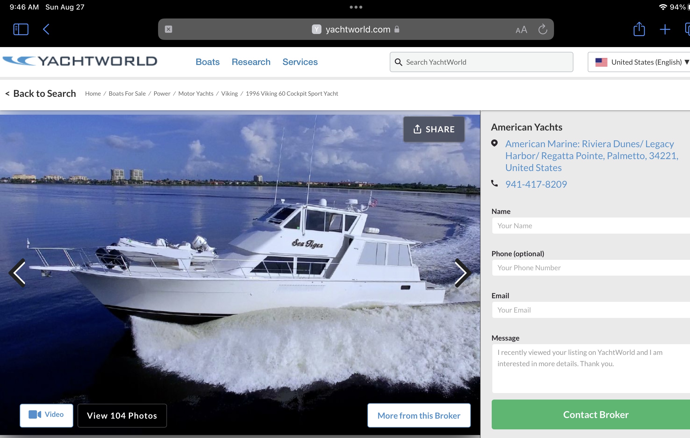

  15. Capt Ralph
    13,427

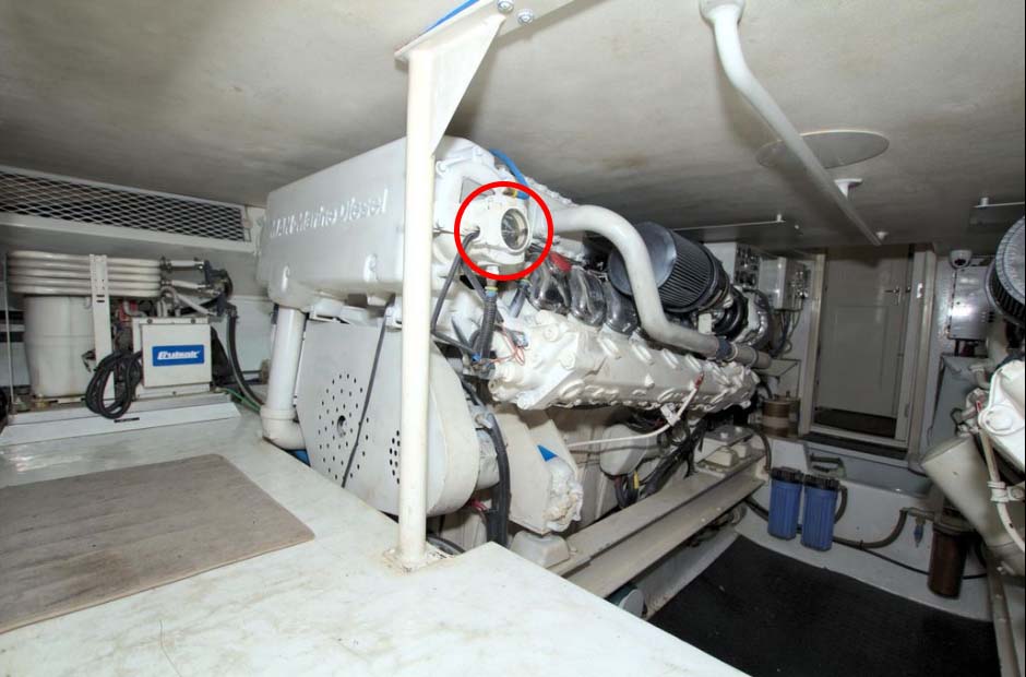

    If that's the boat, she ain't what I figured when I said the engines probably had an easy life in a "cruiser".
    Which doesn't imply they are shot and in need of immediate rebuild, of course.
    Quite the opposite in fact, judging from the pics alone which show a remarkably clean e/r, and even more so considering the boat age and hours clocked. Christ, even the chromed valve covers (which usually look bad shortly after the boat is built!) seem in decent condition.
    Also the fact that the large cover/protection on the belts is still in place suggests that whoever took care of maintenance was very careful.
    I mean, in my boat I got rid of them shortly after I bought her, just for accessibility convenience, but no serious mechanic would do that, because of the risk involved for anyone entering the e/r with the engines running and the pulleys/belts spinning.
    As an aside, @Verdegirl910: if the boat you are considering is indeed the one linked by CR, and if you will go see her, I would be curious to hear what the bit that I circled in red is. Or also from anyone else who might know, of course.
    Me, I've never seen that thing on any MANs, and I've seen quite a few - both older and newer. MAN.jpg
  17. d_meister
    d_meister Senior Member
    Mar 4, 2010
    479
    La Conner, WA.
    Murphy liquid level gauge

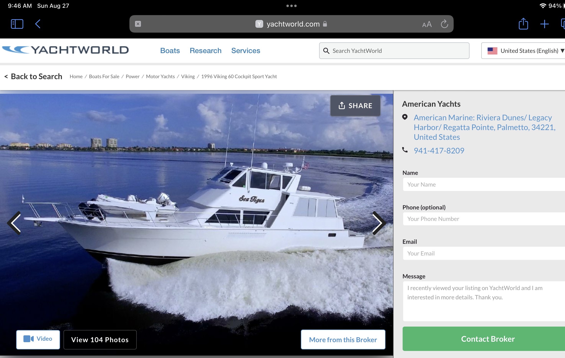

    Also, here is the listing as Capt. Ralph suggested.
