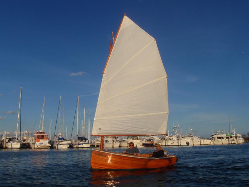

    Clear Awlgrip is indeed another option, probably longer lasting. that's how my Cat boat is finished.

    You have a cat boat? Any pics?

    yes, it's my tender and fits nicely on top of the hatt.! has wooden two part mast which is easy to store and, even more unusal, it's Junk rigged. construction is strip planked over foam cored glass frame...
    since you've been around so fl water for a while, you've probably heard of Dave Westphal... he built it about 5 years ago and we bought it from him a little over a year ago.
    we usually launch it and keep it behind the hatt for a few days at a time and sail it almost daily.
    i'm finalizing the design of a 25' Gaff rigged centerboard sloop that i'll start building this summer, also strip planked with foam core glass frame, and with the same wooden finish. design is inspired by the classic Herreshoffs ...
