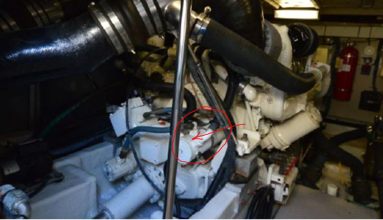

    Never heard of a MAN air cooler failure.
    MAN has no gear cooler. It is installed by the marinizer who mated the engine with the clutch/gear.
    So the gear cooler service depends on the clutch mfg.
    There is some attention required on the tube shaped H/Es. However, Not abused, they last a long while.
    There is a rebuild service available also.
    Now just servicing these, sense MAN has no zincs and better materials than CAT, keep it clean and not full of mud is most all required.

    I'm attaching a pic (click on it to expand) of the gear cooler. Maybe there's another name for it, but as I know it in CUMMINS/ZF world it's called gear cooler.

  16. Capt Ralph
    12,727
    Gear, Clutch even called the transmission, all the same on a floater.
    Yes, That is installed pending the Gear, Clutch or transmission. Probably the only zinc on that engine.
    Some ZFs have internal oil oil coolers. Other MFGs use the coolant from the engine to cool (or heat) their clutch oil.
    That looks like a typical MAN clutch install,, Twin Disk..
    Working on your #11 post now.
