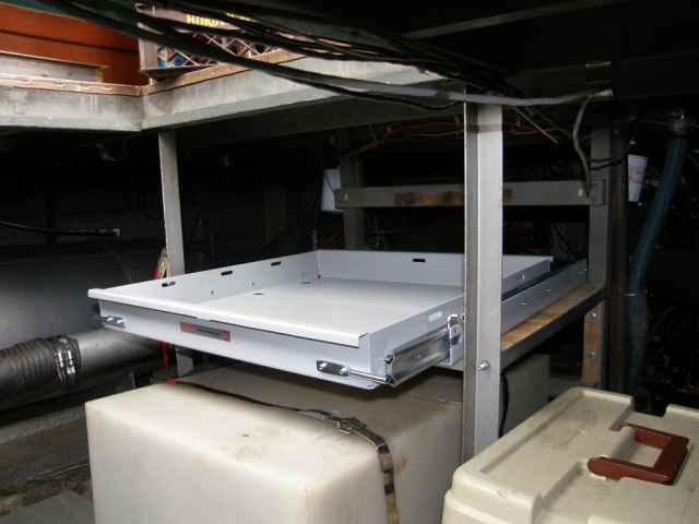

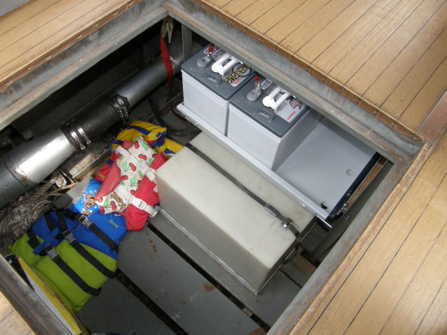

  8. Shangri-La
    Shangri-La Senior Member
    May 15, 2006
    146
    Pensaukee, WI
