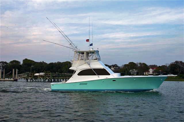

    I would love to see any little custom projects other owners have done on their Post. I currently have a 46 ft. that I have been working onover the years. Will get some pictures posted soon.

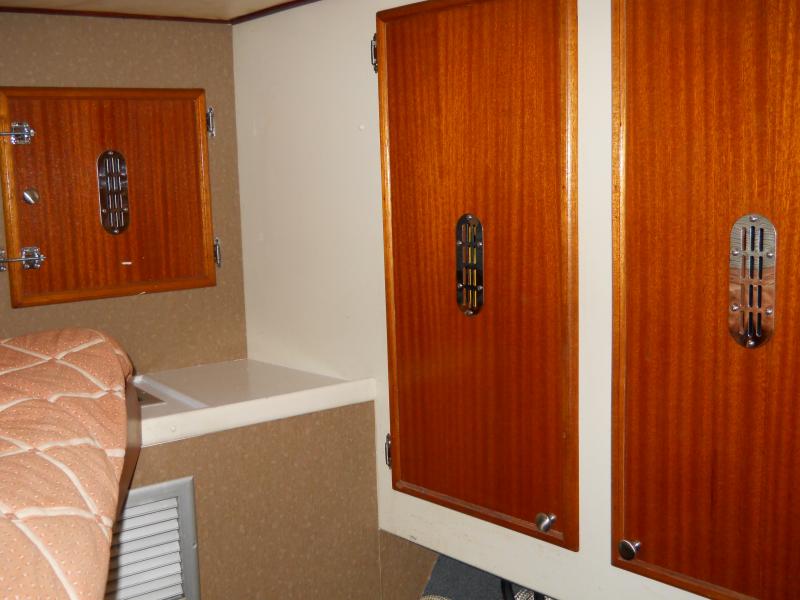

    One of the small projects out of my major renovation is the elimination of all the door handles from the middle of the doors. I didn't like the looks of it from day one and some doors were hard to open that way. I took off the door, measured and marked the location and, using a hole saw, I made two holes near where the old handle holes were. Then I scribed a line connecting the two holes and used my sabersaw to cut out the piece between them which results in a narrow vertical opening with nicely radiused ends (see photos.) Using a router with a half round bit I chamfered the edges on the visible inside and sealed the raw edge with varnish. I sourced some stainless steel vent covers from West Marine that were only a few bucks each and installed them on the outside. New knobs located in the corners and hinges were installed and the outcome was, in my estimation anyway, a good one.

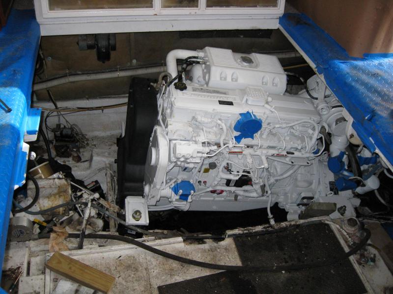

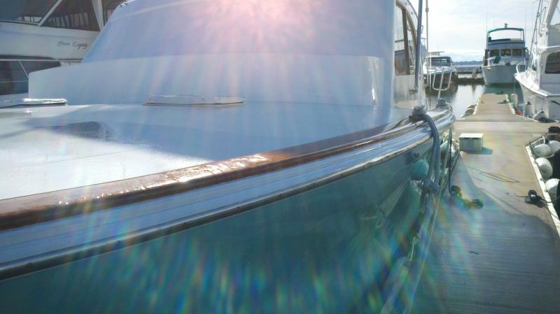

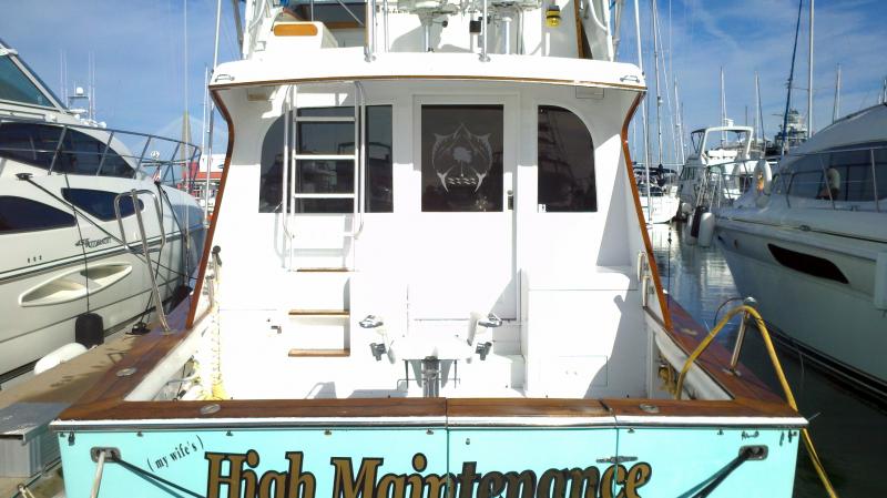

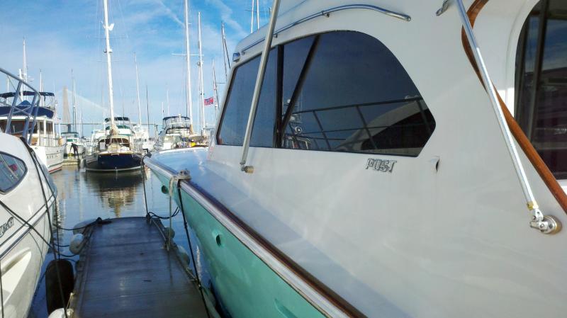

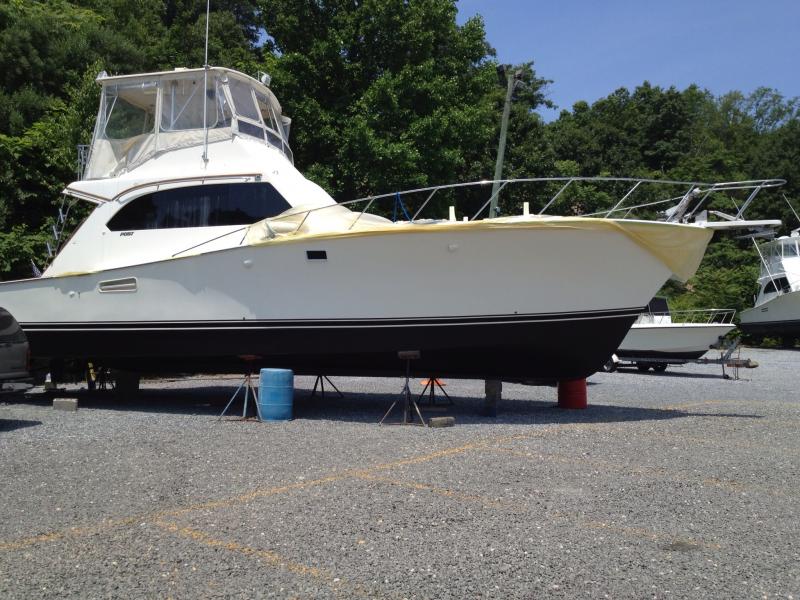

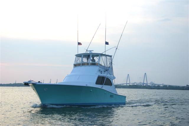

    I have just finished pulling all of the Awlgrip off of the Toerail and the back covering boards. Looks great. I have also repowered my 46 about 1.5 yrs. ago with Cummins QSC 8.3. What a project that was. Here are a few pictures. I also several years ago replaced the Stainless Railing on the ladder and bridge to Aluminum.

    Please tell me more about the repower!
    What did you take out? Why? What are the improvements?
    I want to repower mine with cummins so bad

    Also I would like to see a profile pic of your boat without the bow rail

    I had D.D. 6v92's in prior to the repower. Had done an in frame when I first purchased the boat and was going to need to do another. Actually worked with the Cummins plant located in Charleston, SC. We went with the QSC 8.3's as with theses we had enough room in the engine room without having to cut the stringers. We actually took over 2200 lbs. of weight out of the boat. Crusie went from 22 knots to an easy 26 knots. We top out at about 31 knots and our fuel burn is about 1/2 of what it was. Was pretty $$$. The best thing was NO SMOKE !!! Unreal difference. If you plan on keeping your boat for a while I would sincerely consider it. We were able to take the old engines out and new ones in through the saloon door. I have attached some pictures and these are of the dry fit before the engiine room was completely repainted. I have also attached a profile view that shows it without the bow rails before the cover boards were redone.

    Nice job, your boat looks real nice. What did you use to get the paint off the cover boards?

    wow, the amount of room in the ER with the Cummins vs the Detroits is amaizing.
    Your boat seems to be an 87 or 86 becuase of the porthole in the crew cabin?
    I did not know that that vintage Post 46 came with 692s? i thought the 692s started in the 90s. I could be totally wrong, just wondering....
    how does the boat handle at 26kts cruise?
    Hopefully, I have alot of life on my fresh 671s, but when the time comes it will be awfully tempting to repower with the Cummings.
    Did you end up with a down angle gear? or does the Cummins sit at the angle in your pic?
    Again, great looking boat, thanks for pics

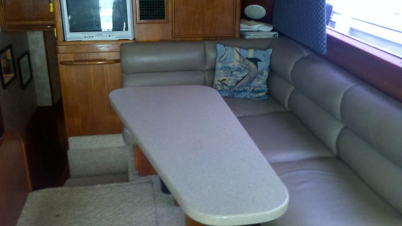

    My boat is actually an 87 that was completed in 88 and has all the features of the 88 as far as the door sliding on the inside, all of the cockpit changes that were made for the 88 models. The Cummins that were put in are 650 h.p. each. I will see about an more photos that I may be able to dig up. The repower has made a world of difference and any Cummins dealer could contact Cummins and ask abou the repower as they did a whole write up and report on the repower.

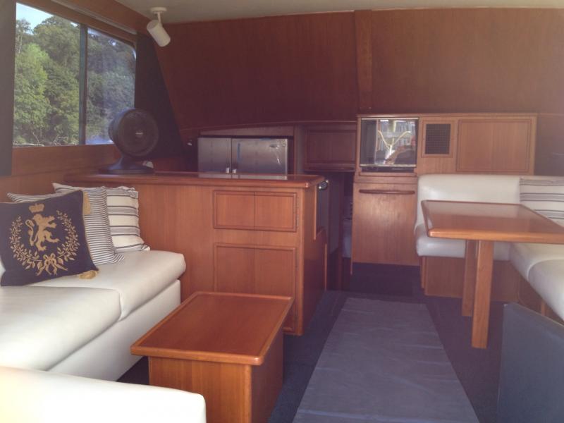

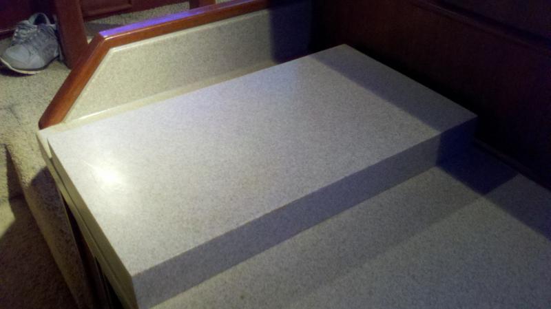

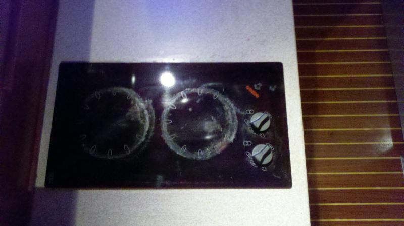

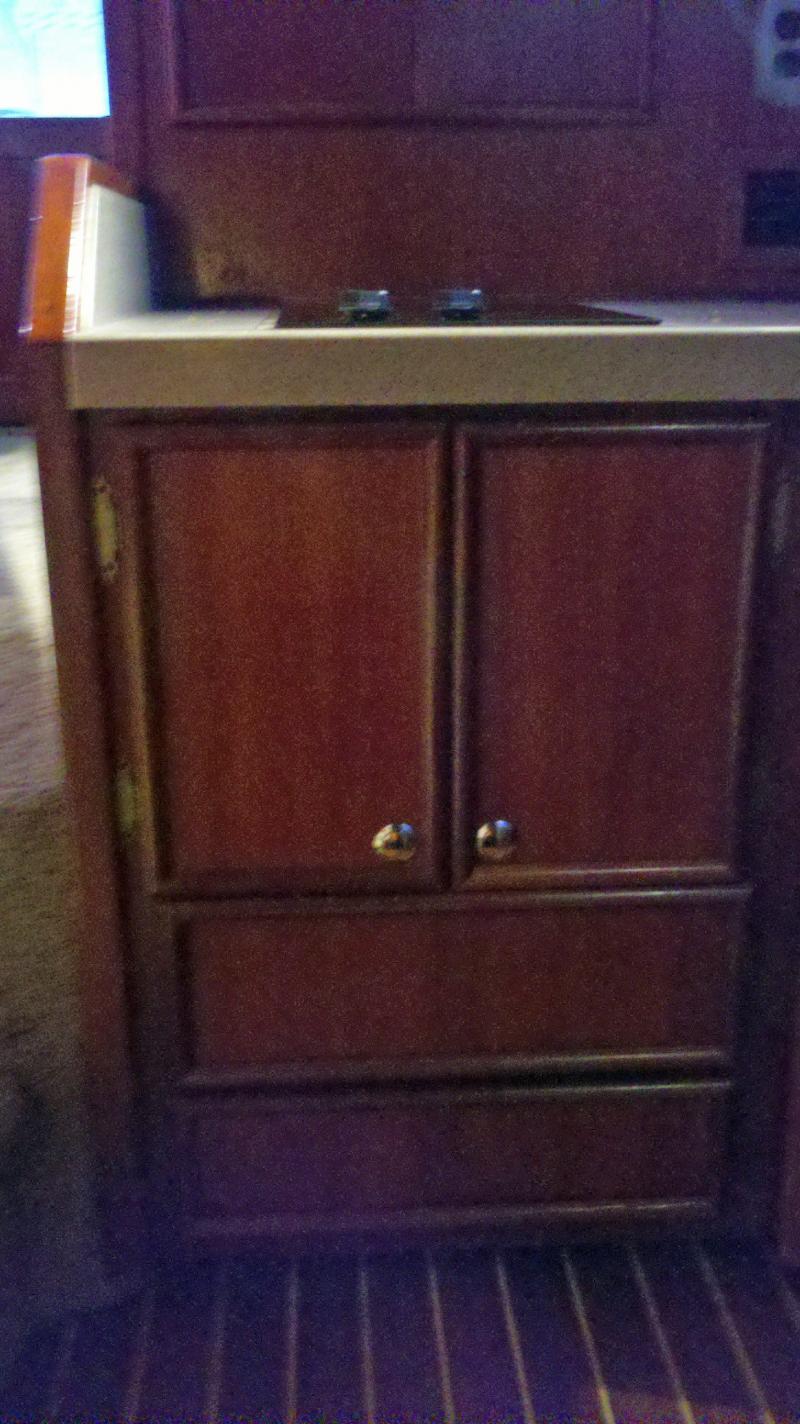

    I have made a few change in the saloon as well. Took out the old counter tops and replaced them with Corian. Took the stove out and put in a 2 burner cook top. ( wife would not be happy with the dirty picture :) ) One other thing was with the table I made it a tear drop shape which really opend up that area. The table was used to make the doors for the area where the stove came out. These gave us much more need storage in the galley area. See the pictures. Sorry some are a little fuzzy.

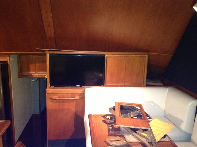

    one of my winter projects
    I have been trying to finish my 32 inch tv installation, as you see I have to finish mouldings and install a/c vent.

    I like it !! Looks like that is a 46 ft as well. What are your plans for the AC vent? I would love to move mine as well as it bl;ows on you the whole time you are trying to eat. Just was not real sure as where to move it.

    Thank You, my boat is a 1986 46ft. I have to check on the angle that I am dealing with, there is a company that makes teak wedge style a/c- heat vents that are beautiful. The original a/c vent as you state blows on the back of your neck if you are sitting in front of it. That vent is a six inch diameter, and the outside dimension is 8 x 10, I am going to slightly change the dimension to 6x10 and use the same size 6 inch hose to attach to it. The wedge vent will go on the ledge on top of the tv. My advice to any Post owners if you are working around your a/c system hoses replace them and filters. When I took this apart the filter on the a/c blower was plugged with dust and dirt, It bothered me every so often seeing dust all over because it got into the a/c hoses as well and came out the vents. Anyway if all goes well the wedge vent will work and I can rip down some teak to make mouldings around 3 sides of the TV. The top will not need a moulding since the tv will use the moulding that is there already.

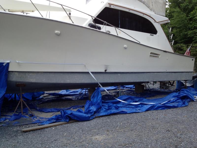

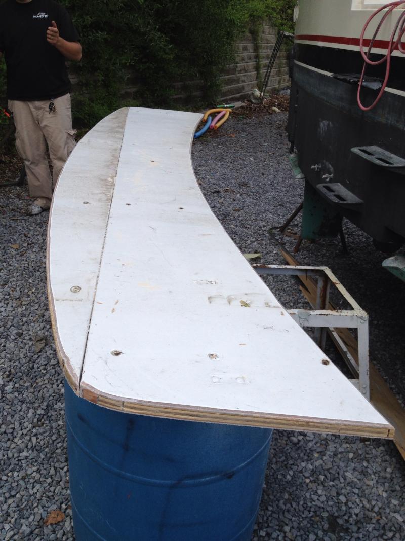

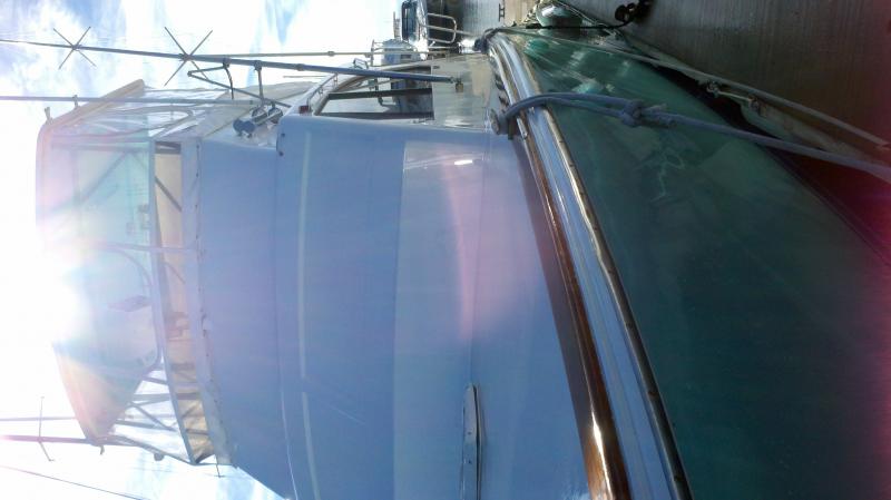

    It's amazing when you start changing one thing on these boats you keep on going. Here are a few pics of this seasons upgrades, and the start of swim platform fabrication.

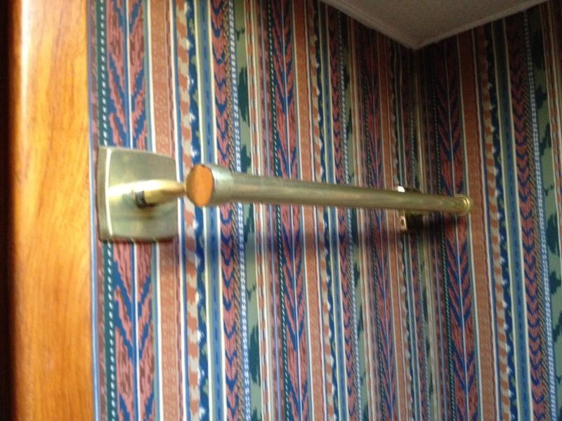

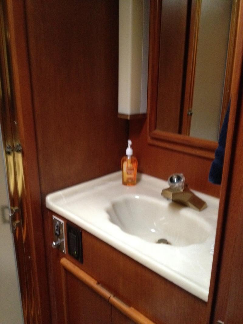

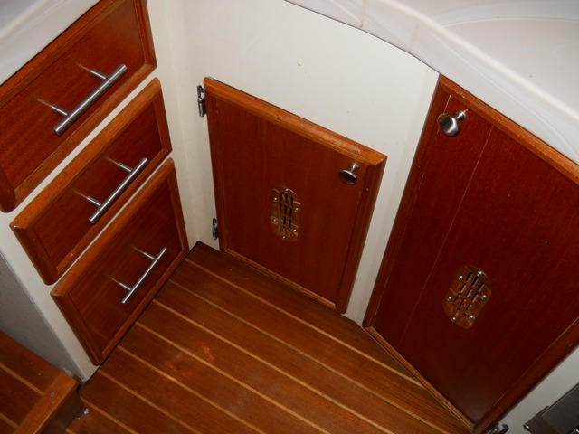

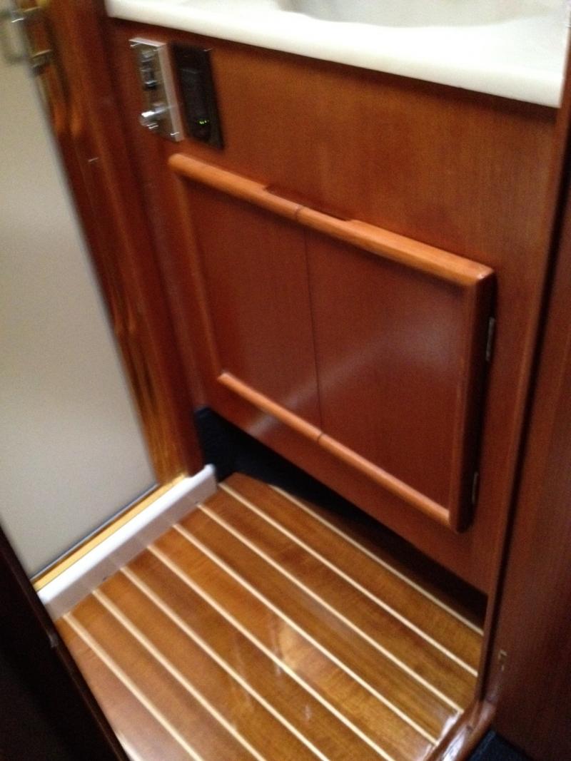

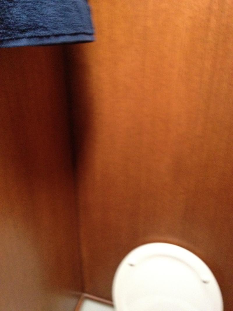

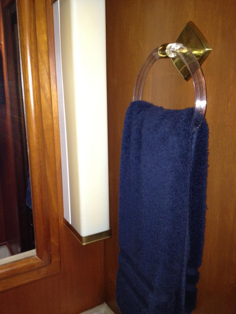

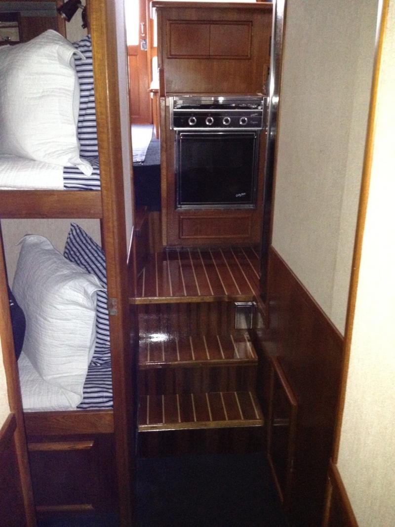

    I removed the wall coverings in the heads and lightly stained the wood and applied satin varnish. Teak and Holly soles in heads, other pics show the hull after it was sand blasted. Also all heads were removed and vacuflush heads installed

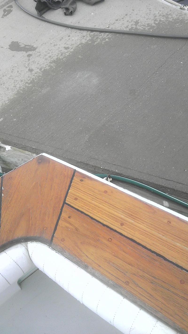

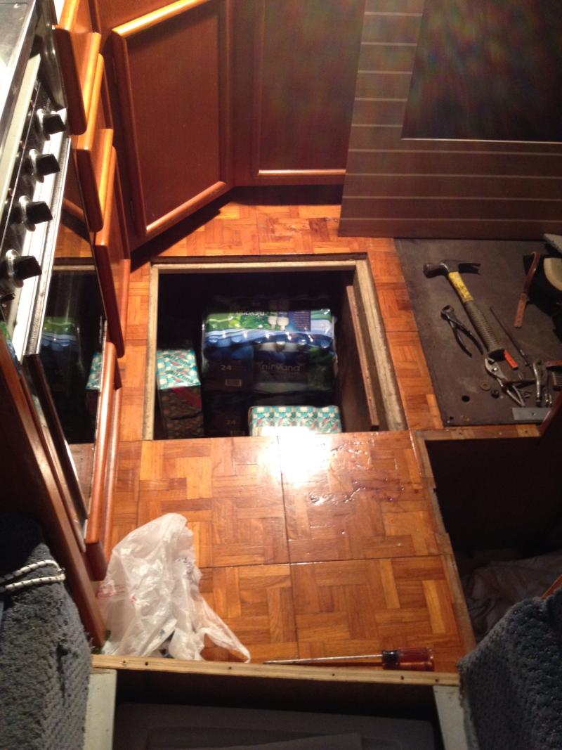

    New teak and holly in galley and stairs, bottom was stripped, barrier coated, microned, and new imron boot stripes

    teak and holly looks great.
    That is a great idea to remove the wall paper in the heads.

    bwt, the swim platform looks great, what did you use?

    Hi Ruby, I agree w/ RT, the wall paper hadda go !
    Thr head walls and floor look great.
