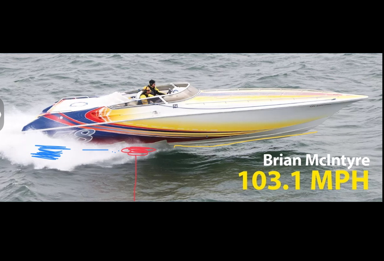

    Does the submerged part commonly referred to as a lifting strip / stake / rail in certain circumstances contribute to stern lift ? When it’s fully submerged .
    Blue is submerged taken to the stern , but sometimes falls short .
    red the disruption area(s) where the majority of hull lift takes place
    Yellow the strake commonly known as the spray rail .Spends it time above the water when the boats running deflecting spray , reducing drag and somewhat also adding a little measured lift .
    I know theses submerged strakes in “certain circumstances “ primarily are there to add stability, and reduce drag , but can if correctly shaped and dimensioned add lift at the stern?
  4. Capt Ralph
    13,436
    That red area are the hull vents. Later designs include these to break the hull from the water by allowing air between the hull and water. Reducing wetted surface and friction.
    There is not much lifting along there.
    I would consider the blue area a chine.
    There are novels of text about these. Round, hard, soft, steak-knife sharp, tunneled, multi stepped..
    Way down under the bow in yellow are the strakes.
    Up forward, they may help pick the bow up, but I think of them as shock absorbers; when the bow comes down or into a wave, they cushion the entry into the water.
    As they travel further aft, they may ad lift but I feel they keep the hull from sliding side to side and help trap air under the hull,
    These strakes usually stop before the last 1/3 of the hull. The after hull I call the pad. This area is mostly smooth on performance hulls as pictured. Most of the boats weight rides on this area.
    When all the other parts work, the pad is covered in a thin layer of air. I recall it was Reggie Fountain that spent all his R&D moneys improving this part of his boats. The smaller, flatter the pad area, the less friction, the faster the boat would run.

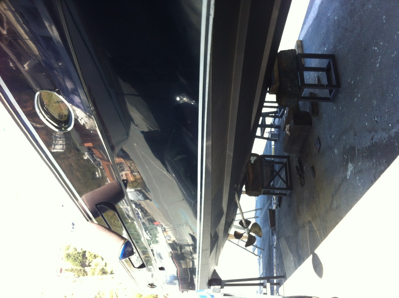

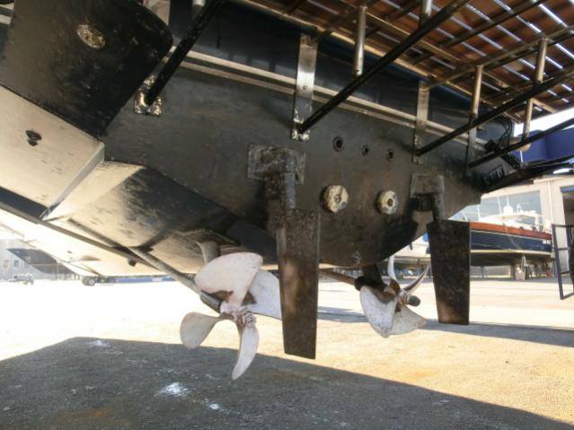

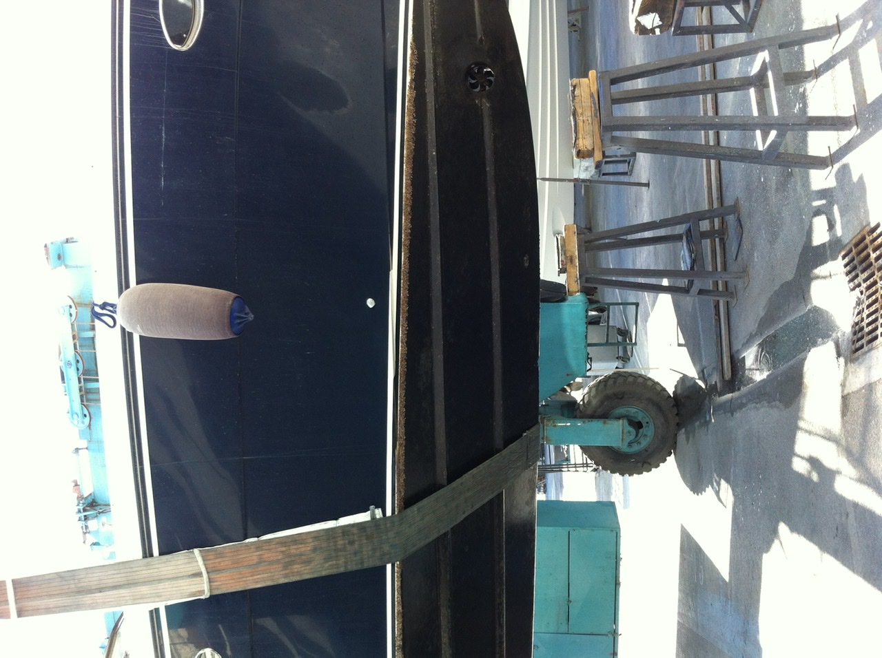

  7. Fiammetta42
    Fiammetta42 Member
    Sep 28, 2017
    130
    Liguria Italy ( boat )
    On a deep V like this 23 degree, the middle set run to the transom and are quite pronounced.It cruises comfortably @ 1800 rpm with MAN s at 30 knots
    There’s a lot of flat surface part way down the hull from the chine .
    Do they contribute to additional lift , net lift at speed .
    It’s got a bottom lifting pad as you can see as well .
    Apologies for the pic rotation guys .

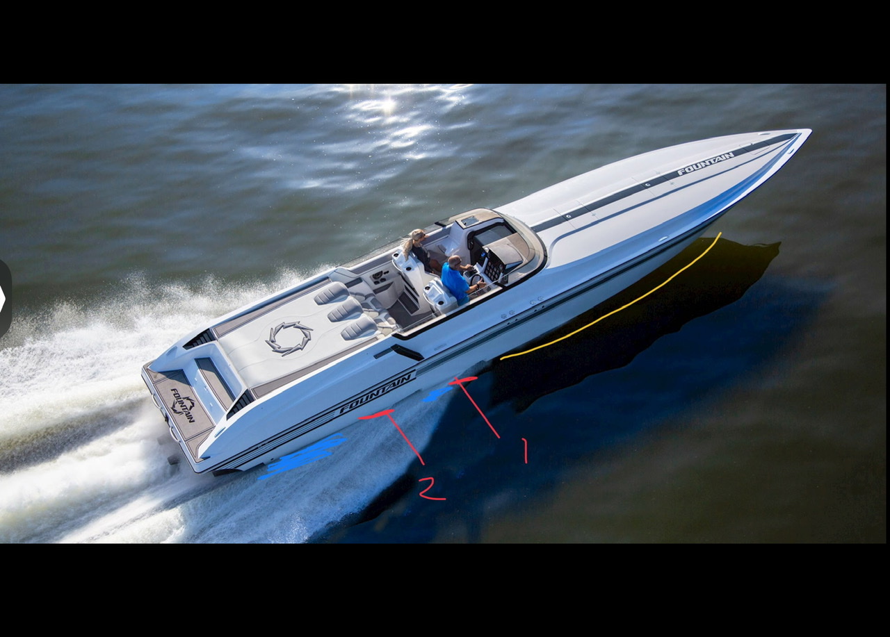

  8. Fiammetta42
    Fiammetta42 Member
    Sep 28, 2017
    130
    No Iam trying to understand exactly what theses strakes do .Particularly if those wider more pronounced ones running to the transom create any lift .
    I think I have excessive lift .
    The reason I ask is say up on the plane running at 26/27 knots .The boat responds to rudder like any other .
    The boat runs very flat requiring zero tab .If a push the sticks Fwds more ( max speed is 38 knots ) the hull rises higher up , you can feel it lift higher and it low running angle say 4 degrees ( guess ) gets lower with out tabs .Tabs on Zero .
    In fact the stern rises so much, along with the rest of the hull so it makes those rudders pretty ineffective.
    For quick emergency type turns I have to pull the sticks back to effectively dip the rudders so they bite .
    At 35 knots full rudder just adds drag the boat still tracks true or if anything deviates by a tiny degree hardly worth mentioning.
    So where is the additional lift coming from ?
    Yes I have been reading Reggie Fountains stuff .He used theses strakes underwater to the transom .Far faster boats so not as wide due to the speed advantage .But nether the less more lift means less drag of the hull in the water = more speed = win races .All the others like Donzi etc and most Ray hunt designs run the strake to the transom of very close .They call them lifting strikes , strips .
    So as the name implies …….do they create lift ?
    Also above a certain boat weight and size the lifting effect I understand is limited .Something to do with froude numbers
    I quote this from a naval architecture forum .
    “Another reason you don’t always see lifting strakes running all the way back .Or very pronounced.
    . Boats with a volumetric Froude number less than 4.0 don't need lifting strakes... for example, a 55-foot boat weighing 60,000 pounds should only need strakes if it will go faster than 42 knots. Location and shape, again, is about finding the balance of the design.” [ end quote ]
    Tend to see them running back to the transom / more pronounced, wider on deeper V more performance orientated hulls .
    I realise something like this stuck on the stern underwater section about 2 ft down at the transom on say a San Lorenzo 95 chugging along at 18 knots isn’t gonna create anything .
