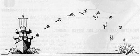

    For a moment there I thought this might be a reincarnation of old technology.

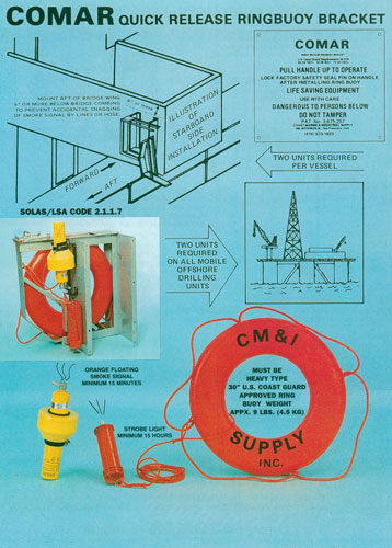

    Reinventing the wheel but adding more things to corrode and sieze. These things have been mounted on the bridge wings of merchant ships for years and work very well.
    It isn't a matter of tossing the ring accurately, it is a matter of instantly putting a flotation device and a marker over the side to provide a reference point, especially for those Sons of Megellan who have not heard of Mr. Williamson. These are mounted on the bridge wings because when the word is passed "man overboard X side" the first thing the lookout or mate does is release the bouy on that side.
