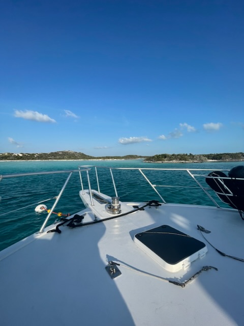

    On my sportfish I used to secure the bow with stainless tensioners for added strength from pounding seas, but the connection to the boat was a stainless pelican hook. However even pelicans can be a problem when extremely tight.

    Are these pelican hooks? Because I don’t know of a way to get them to release quickly without taking the tension off.
