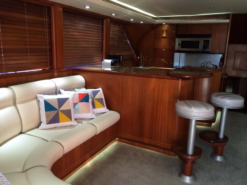

    We replaced the halogen recessed lights with 5w and 7w led lights. All circuits are 120v. Turns out that the LEDs are Too bright. They make a household gang ox style dimmer but we have little micro switches. We tried to place a dimmer inline and out of the way, but when dimmed they don't turn back on.
    Any ideas?

    Well we down graded to 5w lights and turned out great. Went with 6000k cool white lights and new rope lights. Really make the vibe look like a new boat...plus all new softgoods.
  7. Capt J
    14,530
    The salon looks nice. I personally like 2700K because it mimics incandescant light range. But everyone has their own preference.
