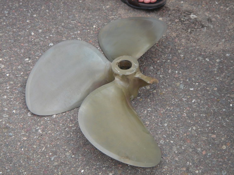

    Fast forward to Friday on Lake Superior 18 miles north of Madeline Island where we are just about to anchor at Cat Island for some swimming in the 73degree water!!! While running at 2200rpm (24mph) I feel a change in the boats vibrations and before I can reach my son to tell him to shut her down I feel the slight vibration give way to one helluva shaking and than the unforgettable sound of a blade or a wheel slamming into the hull. Back about 10' from the stern the water looks like a bomb just went off! We were lucky as it was but one of 4 blades (2 others were cracked as well)and we were able to still manuever into our dock area with both screws at low speed.
    Now I am 3 hours away from the marina, I don't have my spare cause it is in the building I store the boat in, I don't have a spare shaft anywhere cause when the diesels were installed I moved the engines as far forward as is possible changing the length. Can anyone say cell phone?? At that point I called everyone in a 200 mile radius and learned the following good lesson. There are no props of 1-1/2" dia. on anyones shelf. I got very lucky and found a boat on the hard that had 1-1/2 shafts and 22x24 wheels. We stole them as the owner was not to be found and the Marina knew he would approve. Do I owe both of these gents!! So bottom line is that when venturing accross open water as we did you/I must be idiots to not have spares on board unless you like leaving your boat behind for a week like I did.
