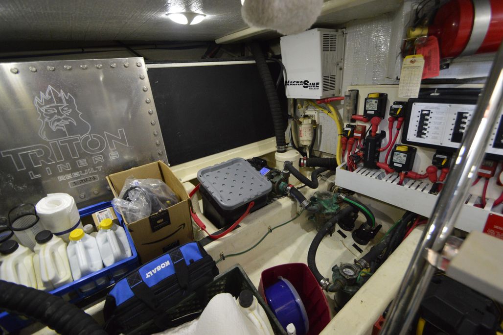

    Check with Triton Liners. They cut the tank open and weld in new plating as necessary. East coast. Aluminum tank I assume, correct?
  9. Capt Ralph
    13,444
    Weld in or glue in. Their web site does not explain this.
    I luv the idea that somebody out there is doing this.
    I look forward to learning more.
    Anybody on YF used these kids before?
    https://www.tritonliners.com/
    They are in Jupiter, Close by.
    Heck yes, OldGeek66, call these kids.
    Thx 993RSR
  10. 993RSR
    993RSR Senior Member
    Jan 15, 2004
    520
    Annapolis/ Palm Harbor
    This is a 42 Sabre, 2013 they did that is now for sale in Del Ray.
    We have used a company out of south NJ that does the same process. They came in and cut the tops out of a 49 Eastbay and 47 Sabre center bilge tanks. Welded in new bottoms, reassemble and pressure test. The early Eastbays had aluminum small tanks forward and fiberglass main tank. I have never used Triton.
