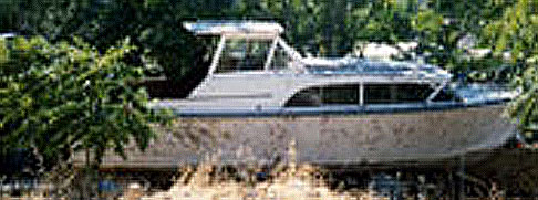

    Anyway, it's a wooden model. I'm still trying to figure out if it's a Commander or a Constellation. It looks likes kinda like this pic: http://www.yachtforums.com/forums/a...525-roamer-pic-100_1696small.jpg?d=1150082802
    But mine looks a little longer and has allot more cabin space I think. Also how is a Constellation "Connie" different from a Constellation?
    I really want to find complete specifications and plans including plumbing and electrical. Also what are they worth? This is a 2 owner boat. The original owner sold it to the guys I bought it from in 1989 and he simple stored it and partially restored it back to original. I just bought it from him. It's a 99% complete original even down to all the original anchors and rigging. Time of course has taken it's tole. 1 of the original V8's has been rebuilt and has 0 hrs but needs the cooling system reinstalled.
    I'm going to refinish the hull in terms of using a belt sander and the correct paint. Then I'm going to look into how to repack the rudder and propeller shafts so I can get her in the water ASAP. From there I'm going to be living on her and slowly restore every tiny detail.
    Any information is more than welcome! Thanks!
    EDIT!!! I've attached an actual picture of my CC. Please tell me what it is, lol! Thanks! Alex
    P.S. Sorry for the horrible quality, I'll have real pictures Sunday night or Monday when I pick the boat up and seal the deal.
    No matter how many Google image searches I do on all different CC models, none of the pictures I find anywhere match my boat. For example, the wrap around front windshield, the curve of the aft side window on it's rear, the upper cockpit shape/frame, etc. Heck, the more I look at the picture, I'm not even sure any more if it's a wooden hull, lol. I'll guess I'll find out everything for sure Sunday when I go to inspect it and purchase it.

    IS it Plywood?
    I presume you read Chris Craft on some major component of the boat to determine the make. Since 'copy cat' boats were not outlawed in the 1960's, it is remotely possible that the boat is not a CC.
    If the engines or some other main component identify it as a CC, and it is plywood as the picture seems. The boat is a Chris Craft Cavalier. This was CC's 'entry level' cruiser. The curved wind shild indicates early 60's my guess 61 -63. I could be wrong (I've slept since then- lol). We had several huge CC dealers on the east side of Michigan (CC was in Algonac at the time) and these plywood boats were everywhere.
    Other 'look-alike' makes (legitamate companies - looked like a CC to the average joe) were Broadwater and Owens. But your pic looks like the original CC.
    Art (just a 'wood guy' converting to metal).

    Yup, checked it out today. It's indeed plywood so it is a Chris Craft Cavalier. I got the Hull # off the CC plate on the engine compartment door.
