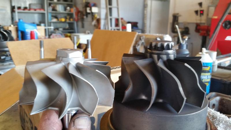

  8. Jimbo1959
    Jimbo1959 Member
    Aug 16, 2010
    77
    Stockton, CA
    actual wheel difference
