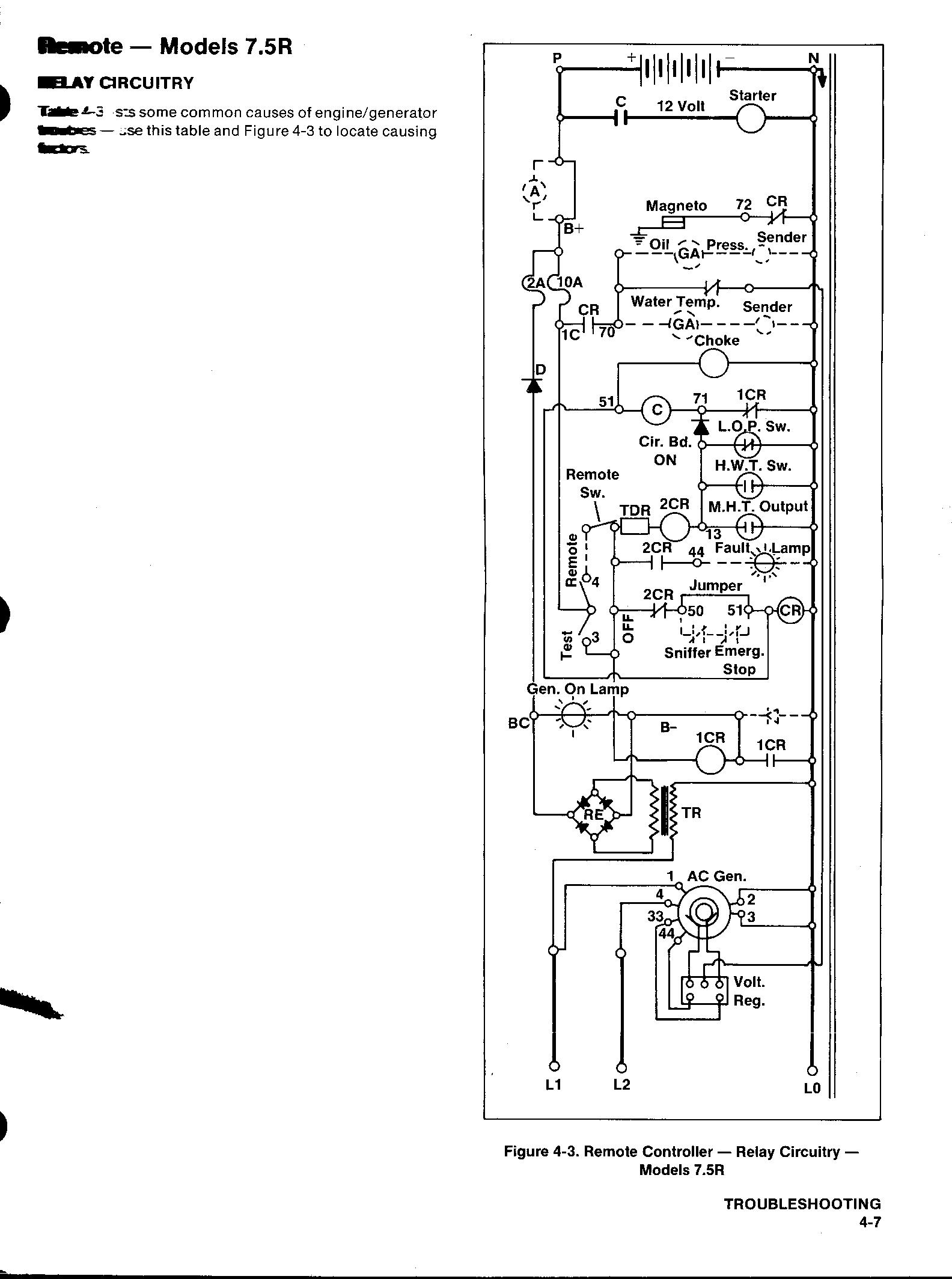

    No temp sender on the exhaust riser. Had a look at the schematic (thanks rcrapps). Diving down to look for that fuse.

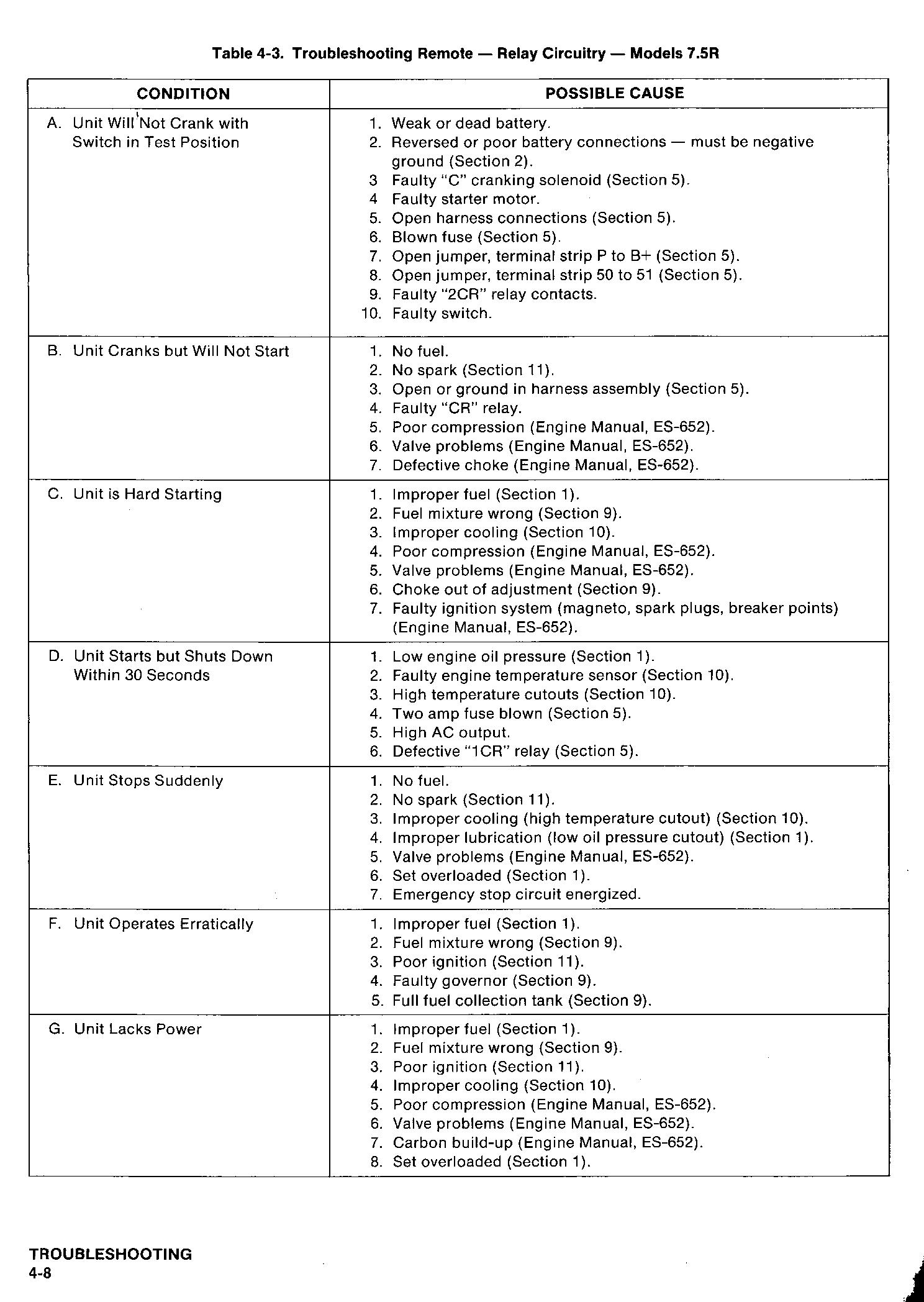

    The book shows data for two different spec'd 7.5Rs.
    One set has a monster of a mother board and three fuses on the back, the other 7.5R data refers to a set with a small board with a 3 pack of relays (I had one of these) and two fuses on the box.
    As far as a gas set goes, I loved that old flat top.

    You're right, there's 2 fuses on mine. A 10 amp and a 2 amp. Guess what! Go ahead, guess! 2 amp fuse is toast. Now, just looking thru my stock for another 2 amp. Then a quick test and try to figure out why it blew. Must be a reason although it doesn't look burned. it's one of the rough service types that may have just given up with all the vibration.
