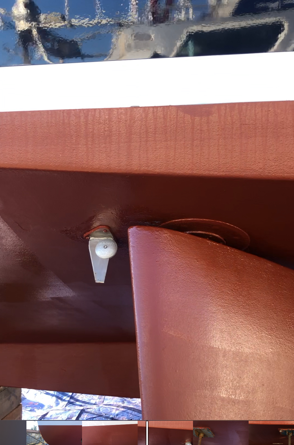

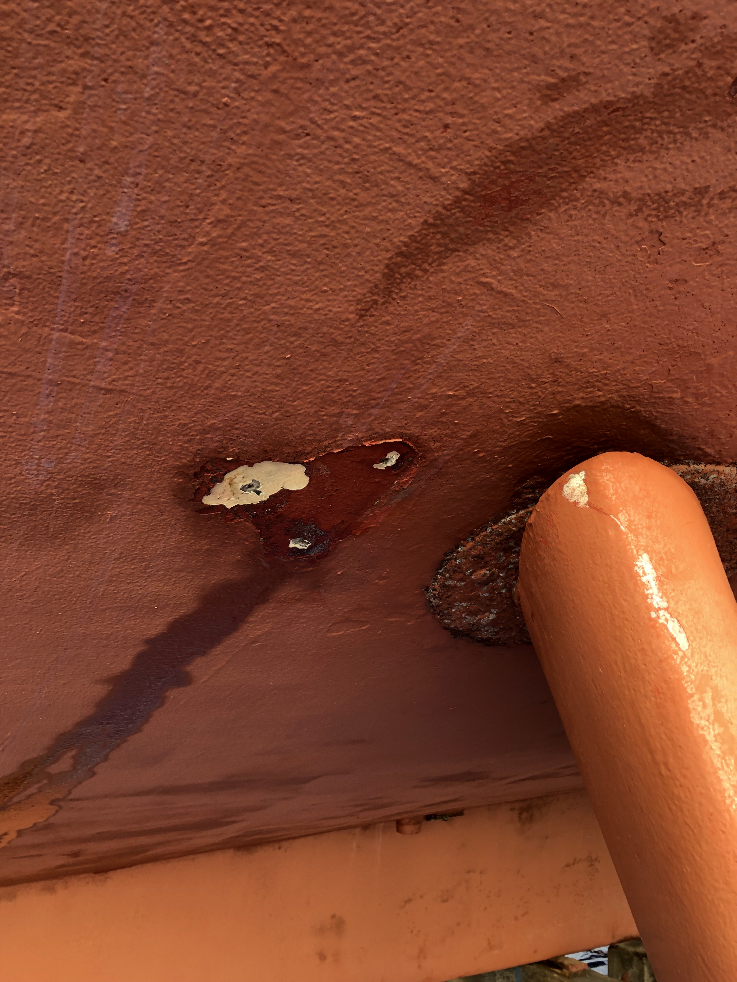

    I have a new to me Rhapsody Lifestyle est 2023 58’ Bruce Kelly designed trawler splashed in ‘84 in Sarasota Fla and it has done numerous trips to Alaska and south through the canal. It has active fin naiad stabilizers and knife Sharp kelp cutters ahead of it. The problem is I’ve lost my second one so far in two years. Sometimes I just can’t see a log whether it’s partially submerged or I’m travelling at night when I hit a stabilizer kelp protector with a log it tears it off. It is usually stainless thin triangle about a 5 inch triangle with a blade coming down off it screwed to your hall when I knock one off the hull I expose three screw holes into my boat, which have to be plugged immediately. I don’t want to screw my new ones into the hull any more. Should I epoxy a 6 inch triangle of plywood to the hull, fibreglass it maybe and install 3 female bolt receivers to make it sacrificial if I hit another log and there won’t be 3 screw hole torn out from my girls belly. Does anyone have any suggestions? Besides don’t hit logs then I don’t have to sit in the engine room and perform my absolutions to my big fibreglass girl!! Tap the pics and they will become easy to see

    Well you know what? A tiny piece of driftwood just yesterday got wedged between the kelp cutter and the stabilizer on the port side! When the stabilizer was moving it loosened the cutters screws and the boat leaked again. Haul out tomorrow now so I am not putting new ones on once my hull is pretty again. fk it. It seems like a ‘6 of one, 1/2 dozen of another kind of thing.! The fitment plan needs to be re thought out. I’ll take a pic in the slings tomorrow.

    I have seen it before but darned if I can remember where.
    Think of a hull form, like the forward lip in front of a bow thruster tube.
    A lip protecting the gap between the hull and gap of the stabilizer fin. Nothing to break off, just gently push stuff aweigh.
