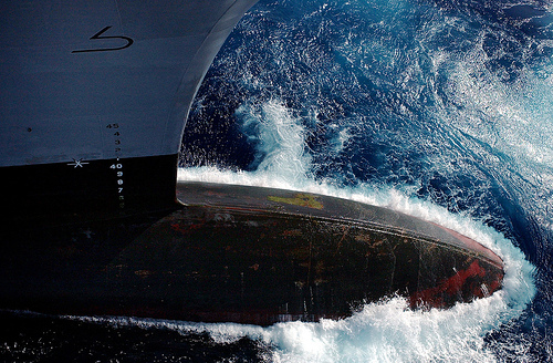

    Keel bulb:
    Bow Bulb:
  6. Capt J
    14,814
    Ok, got it. But aren't keel bulbs usually found on sailboats and designed to produce as little drag as possible and it allows one to run more sail area in order to increase speed, by reduce keel length while still retaining great counterbalance?
