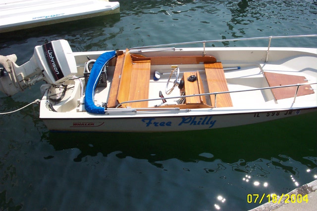

    It has been several years since I've coated the wood interior pieces on my Whaler 15 SS and I can't remember if I used varnish or polyurethane. Since the boat sits outside in the harbor all summer, I think I used polyurethane over the original varnish but I'm really not certain. The surfaces still look pretty decent but I want to keep ahead of the refinishing game.
    Is there some way to determine if the current coat is varnish or polyurethane?
    Then, assuming the current coat is polyurethane, can I cover it with varnish? I usually use Epiphanes but am open to suggestions.
    Or, assuming the current coat is varnish, can I cover it with polyurethane? Suggestions as to brand/type here welcomed.

    BTW. That definately looks like polyeurethane on your seats on the whaler. Varnish would be a couple of shades darker. Although pictures are hard to tell.
