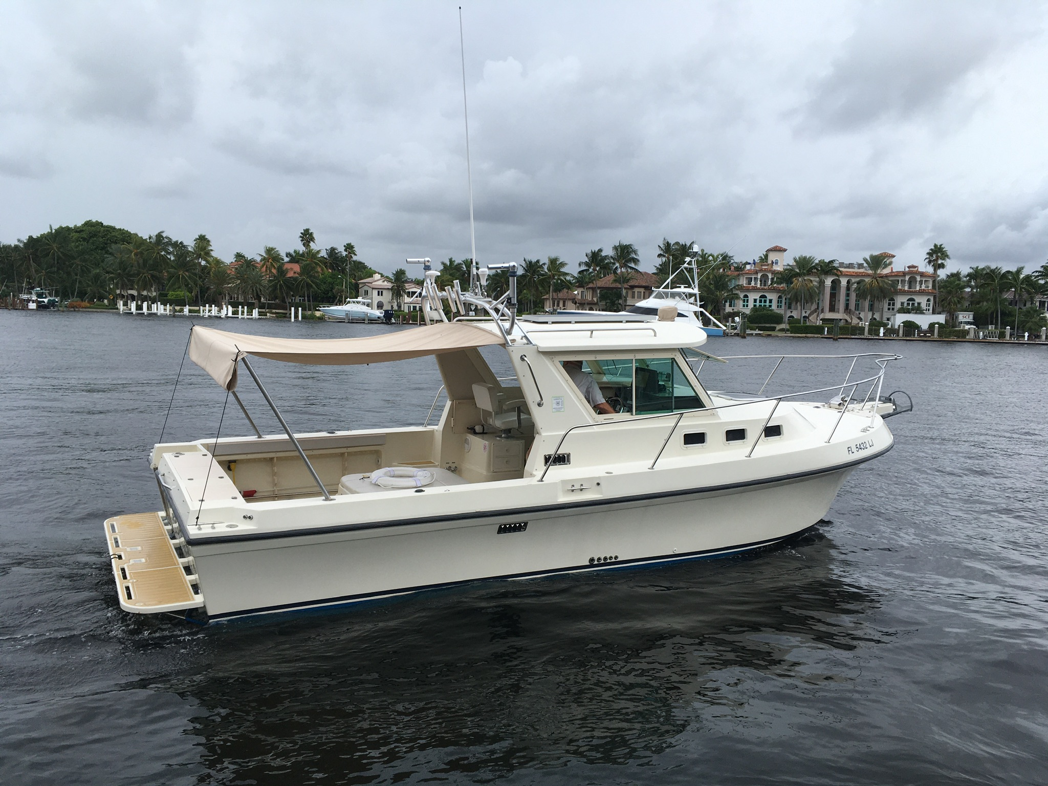

    My tub is 19 years old, always outdoors in South Florida, and looks brand new.
    (After I had the oxidation removed with wet sanding and compounding when I bought it 3 years ago)
    Owner of the same make and model with dark hulls had to paint them, even up North.

    Wow, maybe I looked gullible but I got 2 estimates for painting my hull 3 years ago: (I love the New England Navy Blue hull and red bottom paint.)
    This was before I had the boat wet sanded and compounded shortly after I bought it, October 2017:
    One estimate from Cable was close to $18k, so was an estimate from Patagonia Services, close to $18k.
    (28 foot power boat, see picture: www.odincharters.com)
    Glad I did not paint the boat, happy with the plain vanilla gelcoat from the factory April 2001.:
