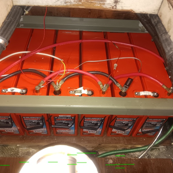

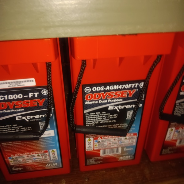

    For over 25 years I have been installing tall TelCom AGM batteries for our customers inverters when there is room.
    Originally using NorthStar batteries, now Odessey owns them.
    A challenge in vertical room but worth it.
    These batteries seem to offer great deep discharge cycles and high current till the end.
    We alarm at a conservative, not so low, state of charge.
    Purchased 5+ years ago.
    6 batteries in a 3 x 2 bank.
    We have a 4kw/24v-120/240Vac Magnum PAE inverter. near seven years ago.

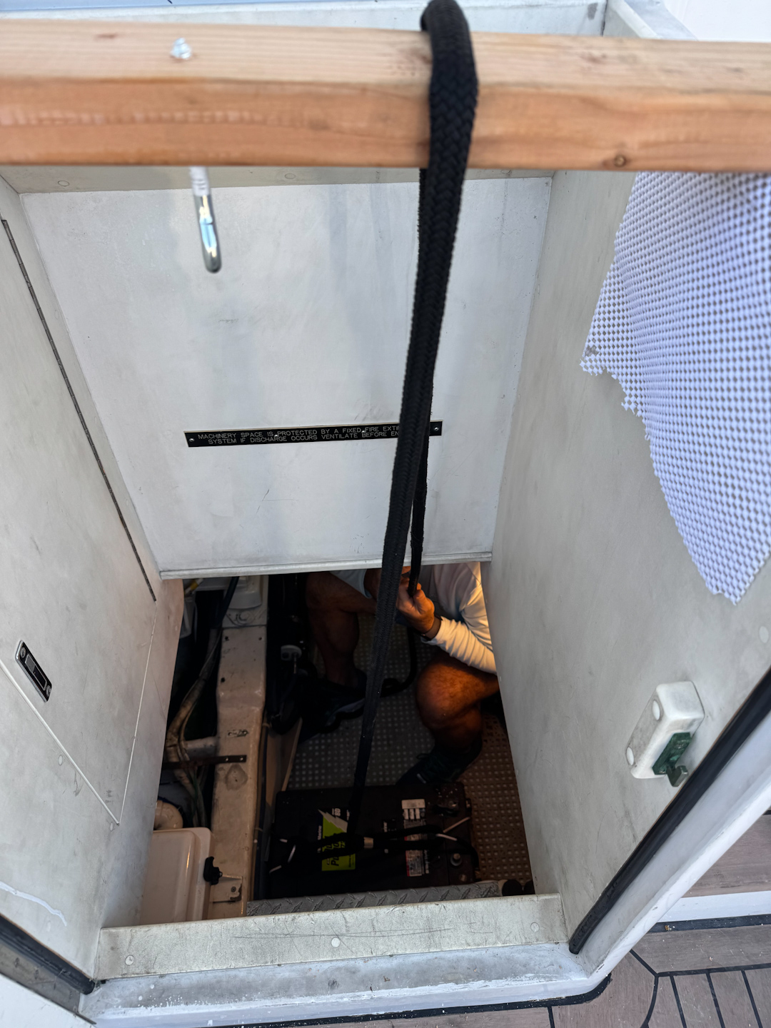

    For you, May I offer moving the inverter and these fancy batteries into the area under the galley deck next to your water heater.
    A ships battery bank (one or two big AGMs) still in the engine room. ACRs on the main engines to keep all up while the mains are running.
    On cool days like we just enjoyed, you need not start the gen-set at all.

    I definitely like the idea of getting the inverter out of the engine room! I fried my previous inverter with reckless water spray.
    That closet with the water heater is under utilized but does have my dive gear (got tired of holding my breath scraping props) and some other junk in it. Seems like it could all fit with a thoughtful layout. Will take some surgery with the wiring though.
    Good input on the Li batteries. I thought maybe they were “there” now but they are awfully spendy and I’m not interested a Chernobyl reenactment either. The golf cart battery setup sounds interesting.
    Wheels are turning…

    You also had some room for tall batteries in the next bilge forward and low. We can make a shelf down there ahead of the big sea-cock.
    If you stay with 12Vdc, 4/0 cables should just make the specs.
