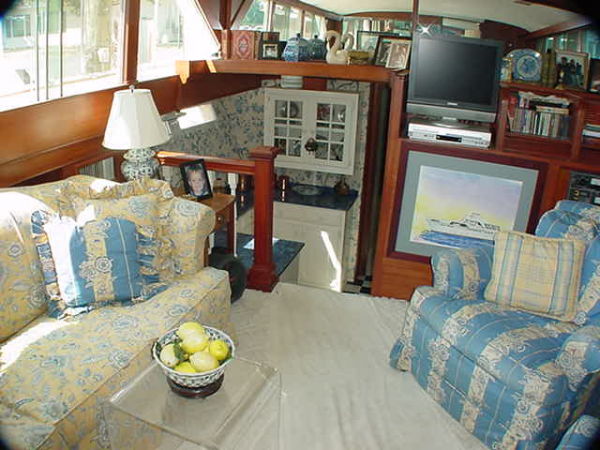

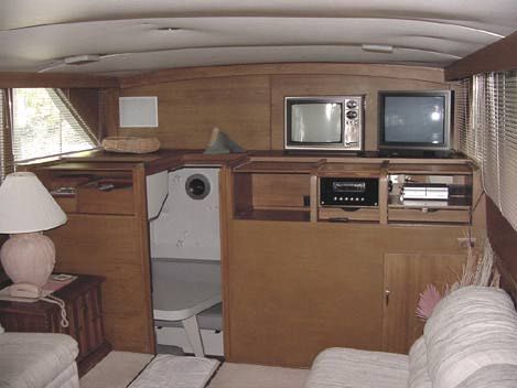

    The original Chris Craft color was a Smokey Brown. Many Chris Craft owners change to a traditional red/brown mahogany stain when they do a refinish. Good old fashioned spar varnish works fine. Choose between a high gloss or satin finish.
    Here are some photos of the original smokey, and a refit/refinish in red/brown (with the bulkhead to the galley removed)
