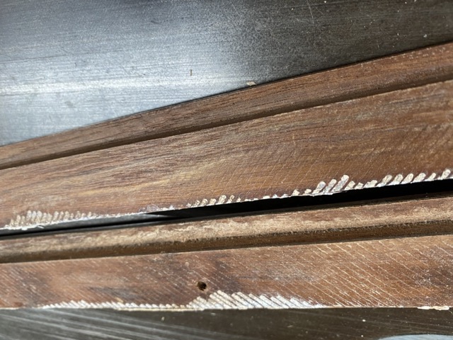

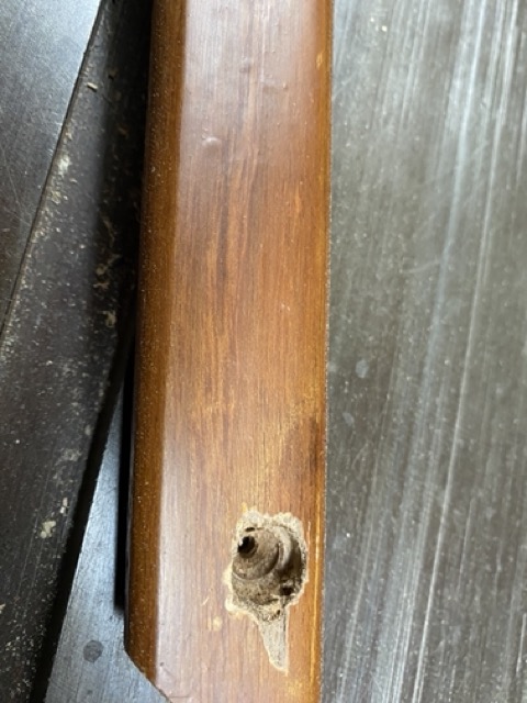

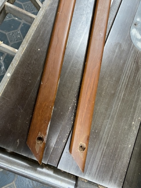

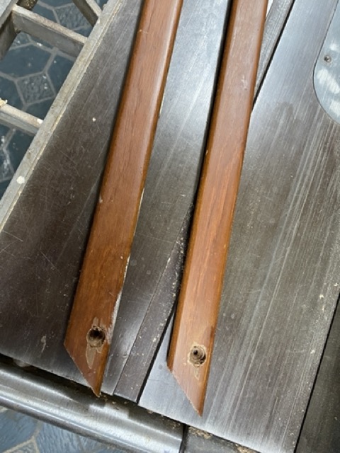

    I'm replacing the mirror glass in the guest stateroom. Drilling out the bungs did not go well and now I'm looking for replacement wood for the frame. What's a good source for this? There's a lot of teak available online but I'd like to match the original stuff as close as possible. I'm even questioning whether it's teak or mahogany. Thanks
  2. Capt Ralph
    14,281
    Been here. Drilling out old bungs is heck with out the correct tool.
    The real wood part gets burgerd.
    To put it back together and still look good, I use larger bungs.

    The surface split in a few places and the bung would have to be the size of a quarter. Gotta replace
  4. Capt Ralph
    14,281
    Past that and the original is really messed up, are you replacing one of many parts?
    And of course, we like pictures, at least one of a wood close up so the grain and color come thru.
    Can you tell if it is stained or varnished?

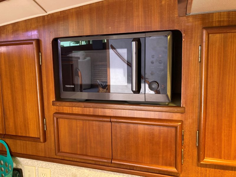

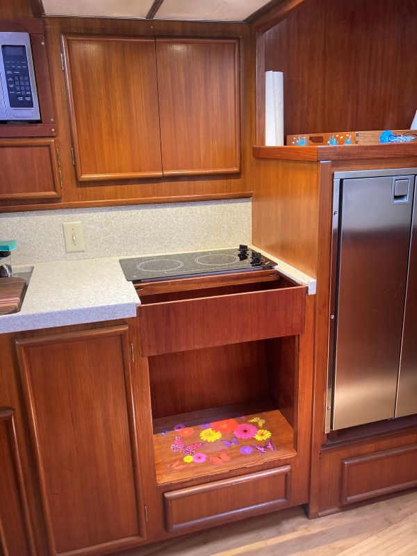

    Some comparisons:
    Mahogony gunstock stain and poly quarter round against original interior wall.
    Top panel over old oven opening new mahogony with gunstock stain and poly.
    Trim under microwave is teak with light gunstock and poly. Plugs from removing old trim (user trim, not original) are teak, but didn't take stain very well.
    Stainless45 likes this.
  9. Greg Page
    Greg Page Senior Member
    Mar 4, 2017
    474
    Annapolis MD
    Won't let me correct
    The quarter round by floor is teak with poly, no stain. Wanted it to contrast both wall and floor a little.

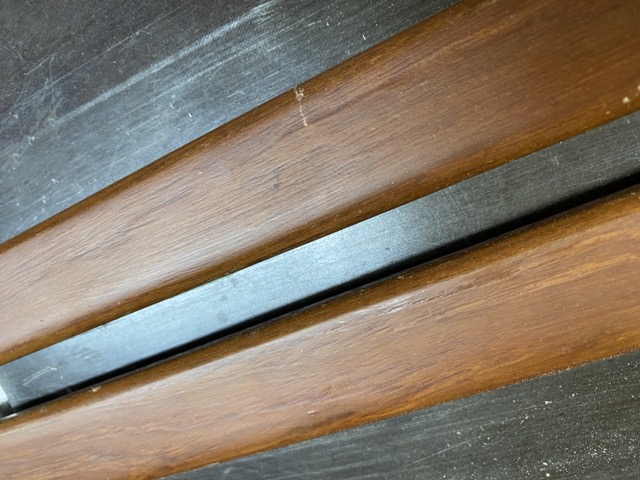

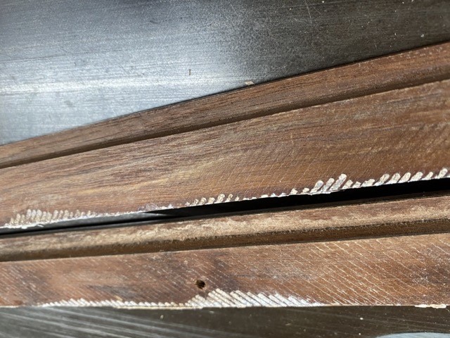

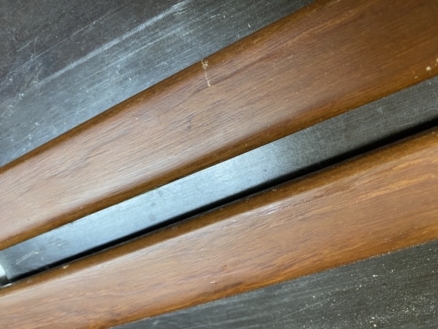

    It's made of the same wood as the rest of our interiors, same finish too. I'm leaning towards it being mahogany

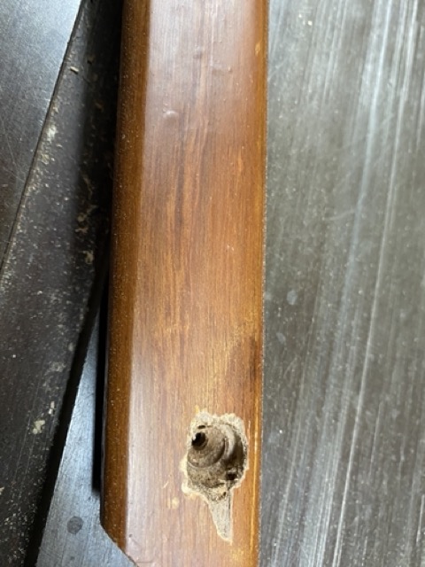

  11. Capt Ralph
    14,281
    Great pictures.
    I'm afraid that is teak.
    The way it is splintered around the old bungs and screw heads.
    I think mahogany would splintered more (longer) with the grain.
    Further, there is no red way down in the screw holes.
    The big problem, matching it no mater if you found the same wood.
