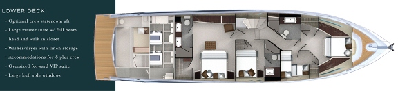

    Somewhat related, I've wondered why one couldn't remove one stateroom and make it just one large master stateroom area. See picture as an example. If you removed the guest stateroom and had just one master area you could have a bit more flexibility in layouts of the master head and staterooms areas. You might also be able to either remove the guest head or change its layout. However, as noted earlier this might impact the load bearing walls. Also, I'm not sure how this impacts re-sale. If one expects to keep the yacht forever this might not be a deciding issue.

    If those walls you are talking about are just partitions then okay, go ahead, but in boats those walls are "Bulk Heads" that handle the load of the deck above, messing with those comes at great cost. Consult a marine engineer or a yard experienced at refitting interiors.
    Tell us how it goes with you, this should be useful.
