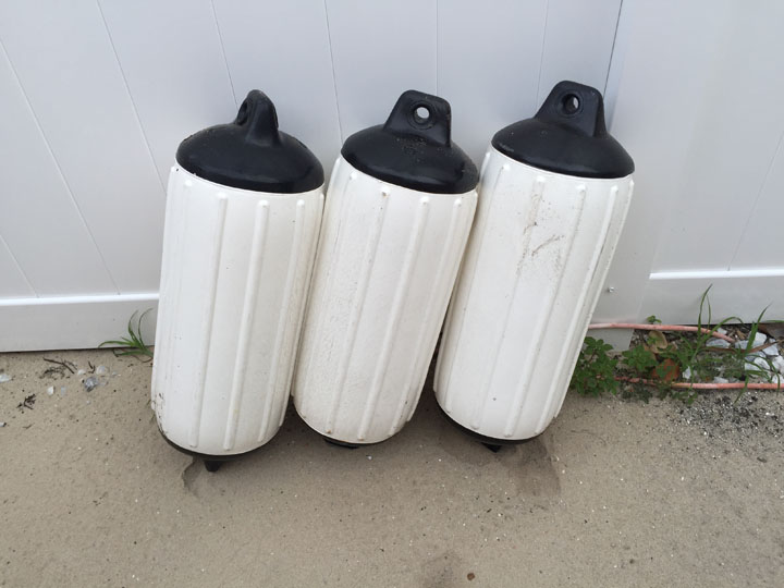

    This thread reminded me that I have 3 TaylorMade fenders that have been sitting outside, in direct afternoon sunlight for the past 6 years. I bought them 10 years ago. They are still inflated!

    Is it time you put them to use ? They look good as new.

    They do look lonely....

    BTW, we just last month got a warranty replacement for a TaylorMade SuperGard like those in YF's pic; dunoo how old, probably 17 years or so... and it was finally beginning to gradually lose a little air over time. Easy swap at the nearest West Marine.

    Was down at the boat earlier and check my fenders after looking at your pic, thought those fenders look familiar, we have one and use it near the swim platform when tied to floating docks. One of our collection of fenders left over from previous boats too, some are collecting dust like your Taylor's, but never know when they might be needed.
