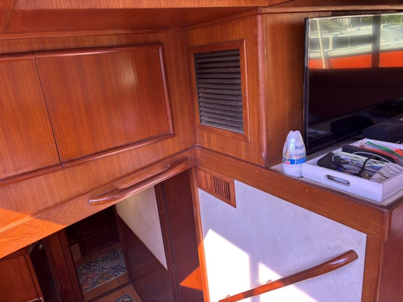

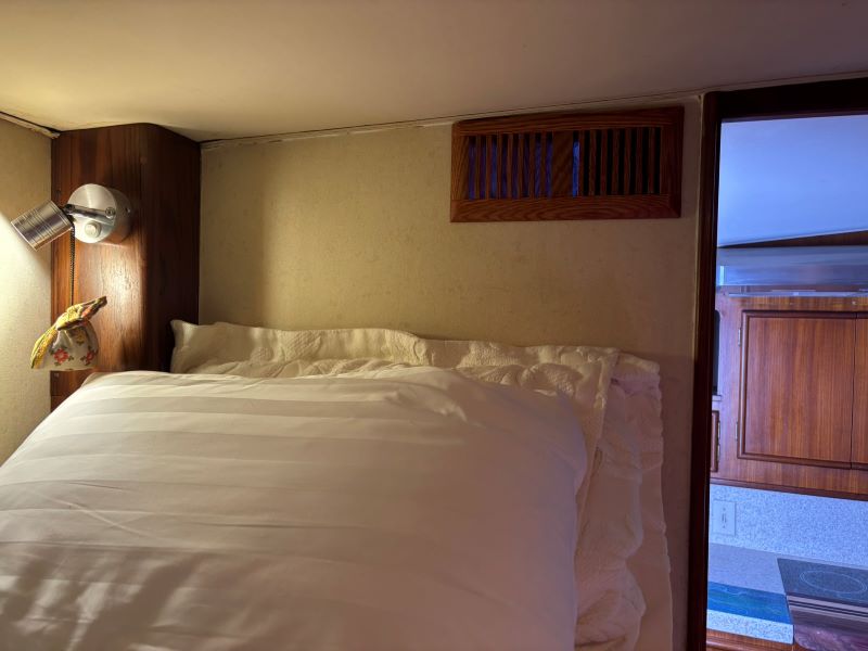

    I've been mulling for a couple years how to get the guest cabin to cool/heat better when guests have both cabin doors closed (43 has a door to the head and a door to the galley). Finally got around to doing something and it works well.
    I had considered a vent through the door but never liked how it would look. I also considered venting the cabin into the return for the salon that runs above it but never felt comfortable with my skills at installing a vent through the cabin vinyl ceiling.
    Instead I cut an opening throug the wall and installed a couple of wood vent panels (actually made for 4x10 floor HVAC ducts) on each side. Finished it up today and tested in the 90 degree heat (100+ heat index). Closed both cabin doors and let the GenSet and AC run for about 20 minutes and when went inside it was as cool as the rest of the boat. Looks pretty much like it was made that way.

  2. Stainless45
    Stainless45 Active Member
    Jul 19, 2019
    173
    Post 46 Long Island NY
    Nice work.. I replaced all the ducting in mine and bumped up the size of the registers too. Every bit helps
  3. Davidoc
    Davidoc Senior Member
    Aug 29, 2005
    271
    Winter:Delray Beach, Fl Summer: Bahamas
    A better solution for our application since we anchor out a lot and do not run the salon air conditioner or the generator all night, and we run the forward AC off the house bank, we need the guest rooms doors closed.
    Do you remember the size of vent and duct you ran to guest room? Thanks
  4. Stainless45
    Jul 19, 2019
    173
    I upped the duct size by an inch.. there is a Y splitter coming off the unit which I changed out to increase the size, I think from 3" to 4" if I remember correctly. This was to allow more flow to the master room forward, maintaining the same for the guest room. MSI makes the splitter, I've found them on Defender and other sites.

  5. Davidoc
    Aug 29, 2005
    271
    Thanks alot. That one works for me.
