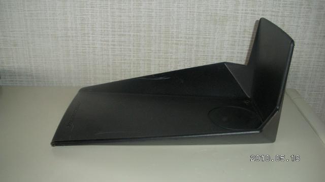

  4. AMG
    5,392
    This is one from Hella, 290 x 210 x 120 mm, but often they are custom made.

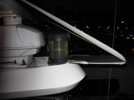

  6. mmss1
    mmss1 New Member
    Jul 11, 2010
    41
    San Remo
    Here is a photo of our experimental shade. The length is 320mm from the fwd end of the light. The light is mounted approximately 17m from the bow and 6m above deck. This is more or less the same as the ratio between the length of the shade and the height of the light meaning that we have to obscure the complete light (as seen from deck level).
    I thought that the Fresnel lens focused (almost) all light horizontally and that we therefore only should have to block the lower part of the light, i.e. use a shorter shade.
    Two notes:
    1. The lens is not really clear and should probably be replaced.
    2. The pattern on the lens is rather "corrugated" than a proper Fresnel cut.
    Can these things increase the dazzling effect?
    Best regards!
  7. Capt Bill11
    Capt Bill11 Senior Member
    Feb 27, 2006
    1,458
    Sarasota/Ft. Lauderdale FL
    I would change the lens for sure. Have you tried tilting the light up at all?
  8. mmss1
    mmss1 New Member
    Jul 11, 2010
    41
    San Remo
    Yes, I agree with the lens. The light seems to be of the brand "Krachtig" which I can't find on the internet so we probably need to change the whole assembly. (Just a matter of convincing the owner...)
    However I don't think that we should tilt the light. That would affect the range and would most likely be illegal. Thanks for helping us to find a solution though!

  13. Capt Bill11
    Feb 27, 2006
    1,458
    I didn't mean for you to tilt it permanently per say. Just wondering if it would have any effect. And if so how much tilting might cause a positive change. If any at all.
  14. Capt Bill11
    Feb 27, 2006
    1,458
    While a shade will most likely be the answer in the end. I would think that a new clean/clear lens will help direct the light beams in a more proper focused manor. Where as a frosted Fresnel lens would cause them to scatter and lose focus.
  15. mmss1
    mmss1 New Member
    Jul 11, 2010
    41
    San Remo
    Thanks for the tip! Ours are probably too old to be found but the DHR
    lights seem to be a good replacement.
    Yes, we have decided to try to make a shade but your suggestion to replace
    the lens with a clear one will not only improve the range but hopefully also
    reduce the dazzle.
    Thanks to all who have replied!
