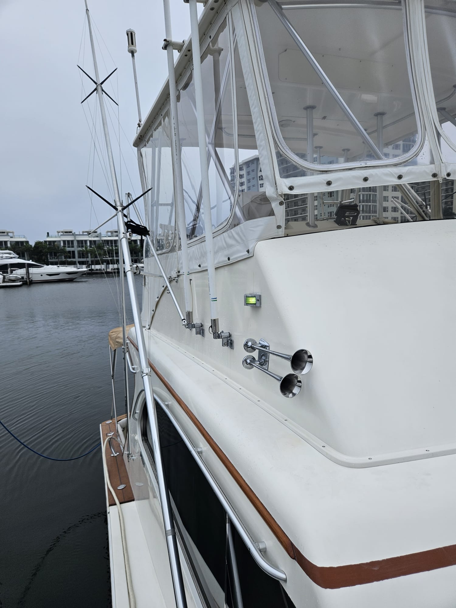

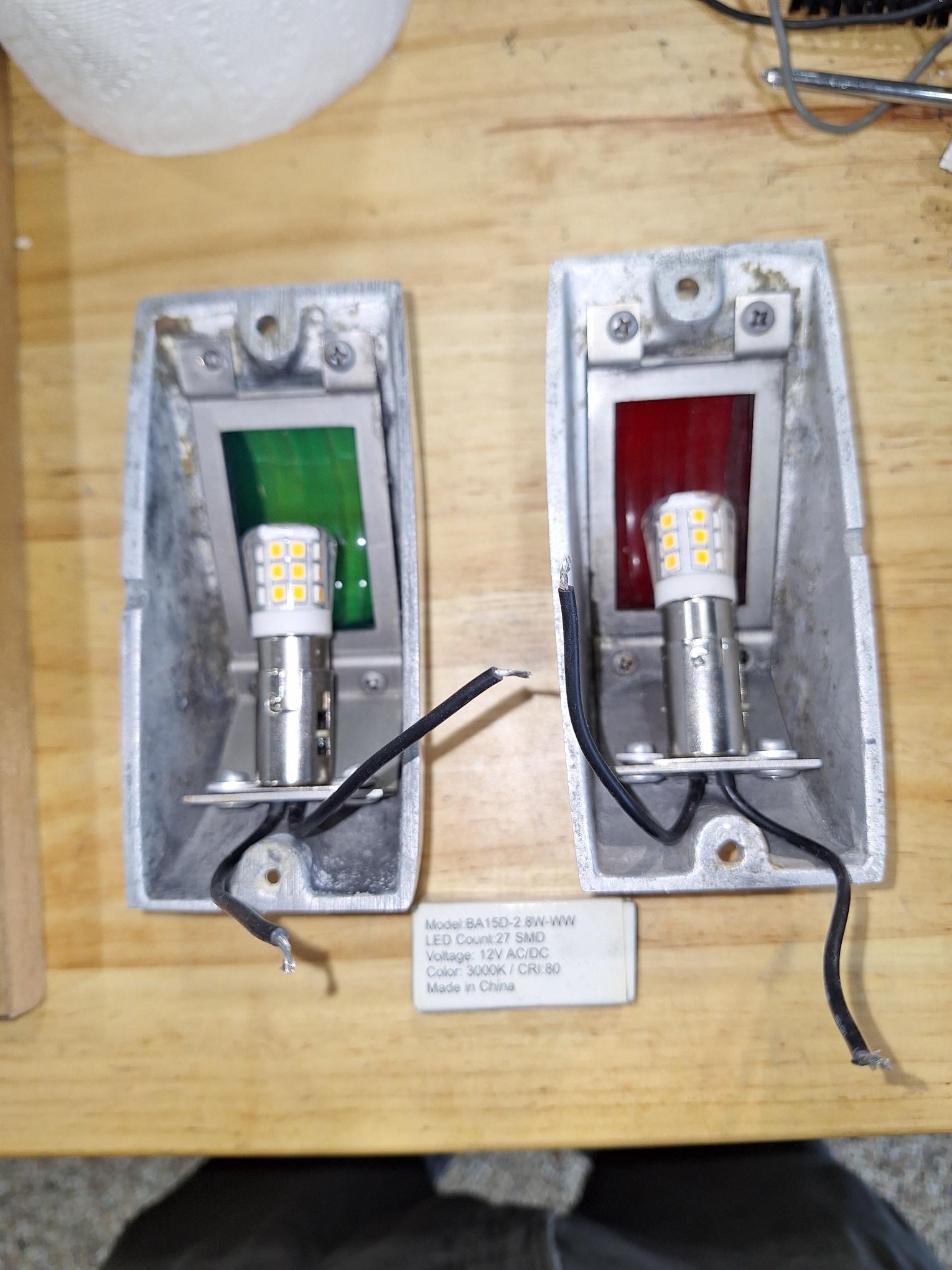

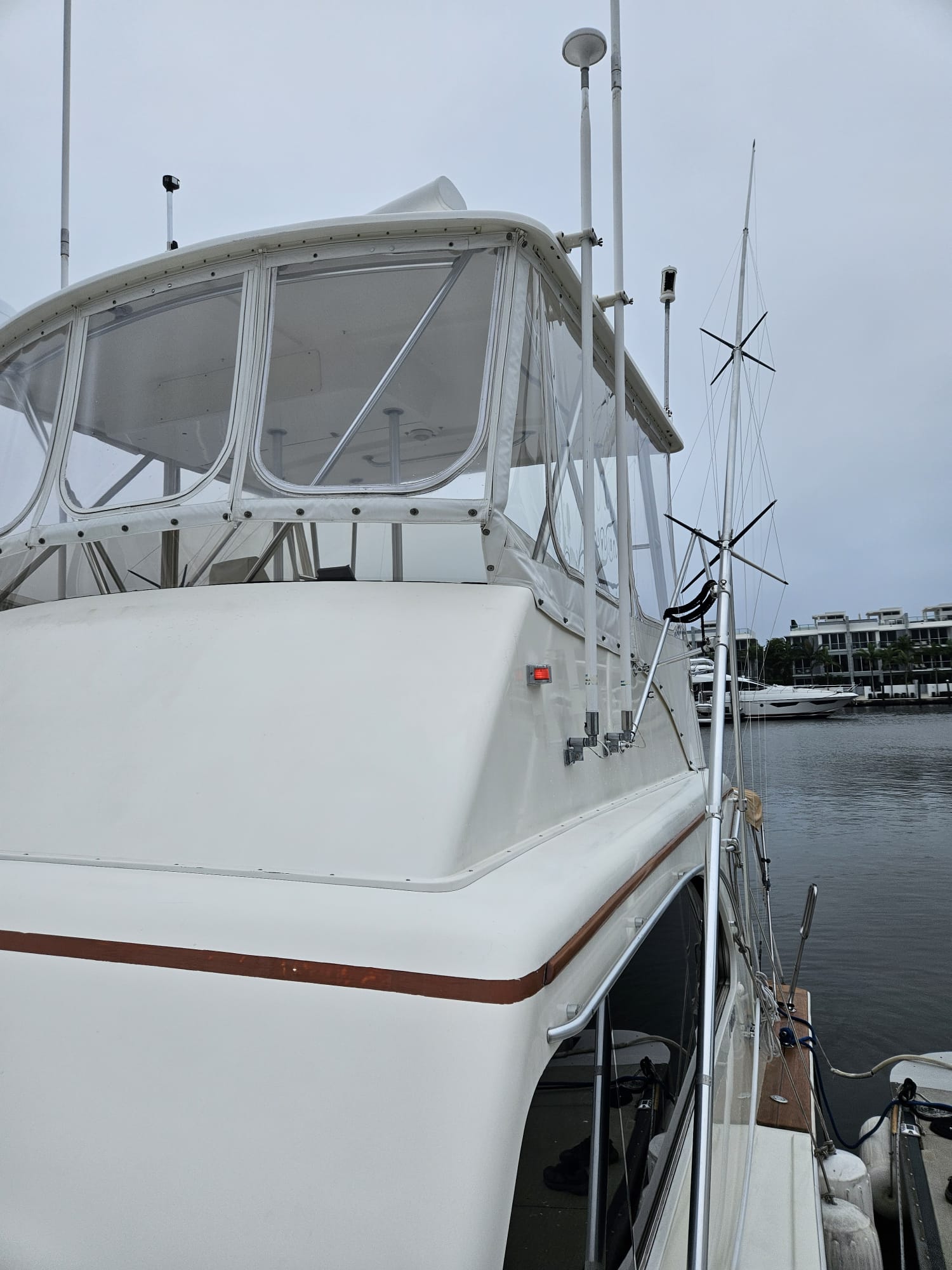

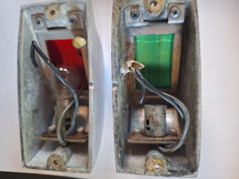

    I've asked this question a few years back in a post and some people really tried to help but I was not able to come up with anything at the time that would work for me. Just thought I would ask one more time to the group. Anybody know how to save these nav lights? I think they're classy and special for the boat. I don't want to change the fixtures I'm willing to put LEDs inside but I've got to figure out a way to repair or replace these any ideas?
  2. Pascal
    8,546
    New sockets and LED bulbs.

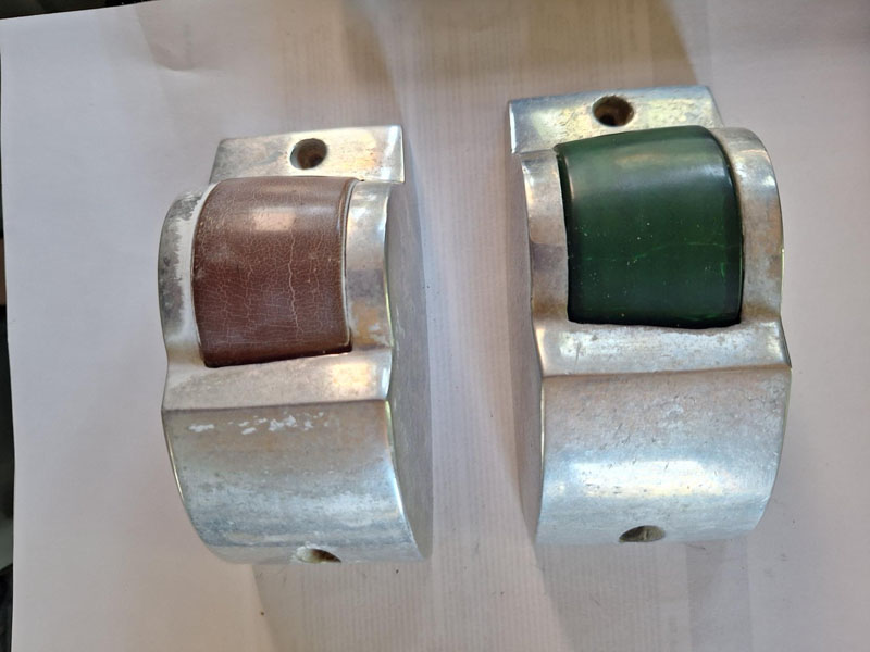

    You could go to a fab shop that does aluminum work, they would have the stuff needed to polish the housings.

    I'm sure a better plastic shop can make some kind of new lens. Even clear if you use colored LEDs.
    The alloy looks pretty good enough for cleaning and at the worst; powder coat vs re-anodizing.

    You could get them polished or plated. A triple nickel plating gives a somewhat warm hue that I personally really like. Did it with a few of the deck hatches years ago. Came out great. Def rebuild with LED guts.
    Davidoc likes this.
  7. Davidoc
    Davidoc Senior Member
    Aug 29, 2005
    260
    Winter:Delray Beach, Fl Summer: Bahamas
    Thanks, they are on the bench and I'm doing just that.
