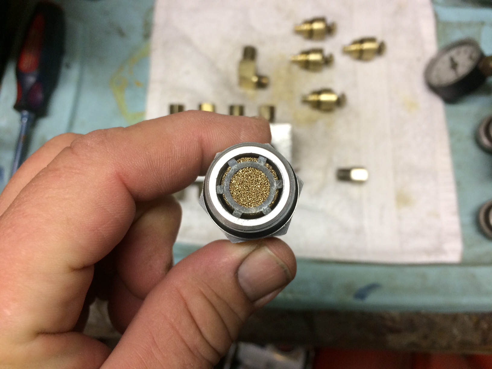

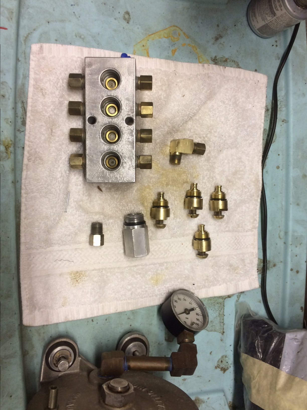

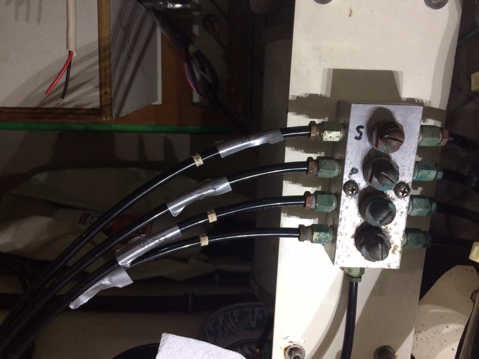

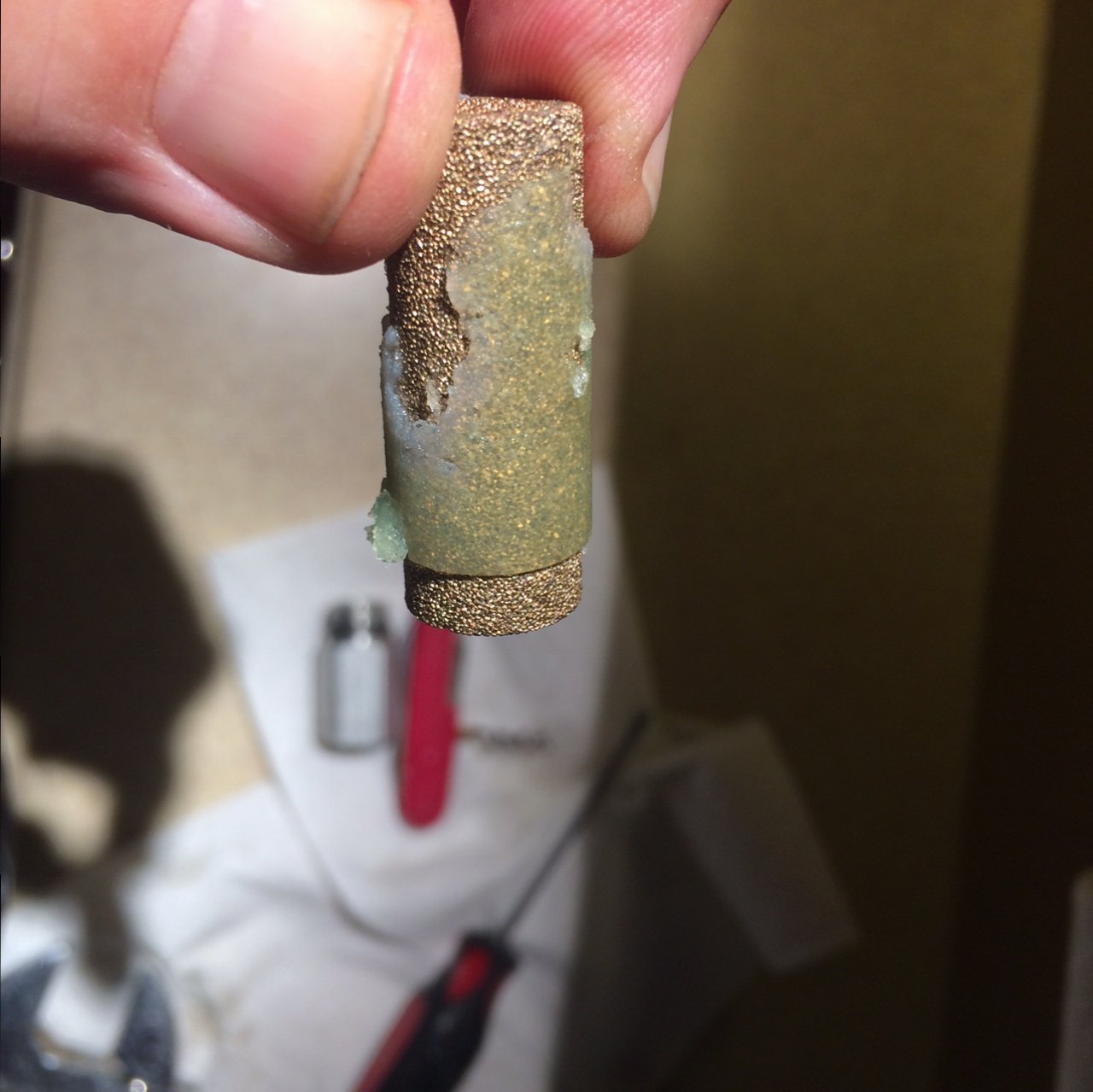

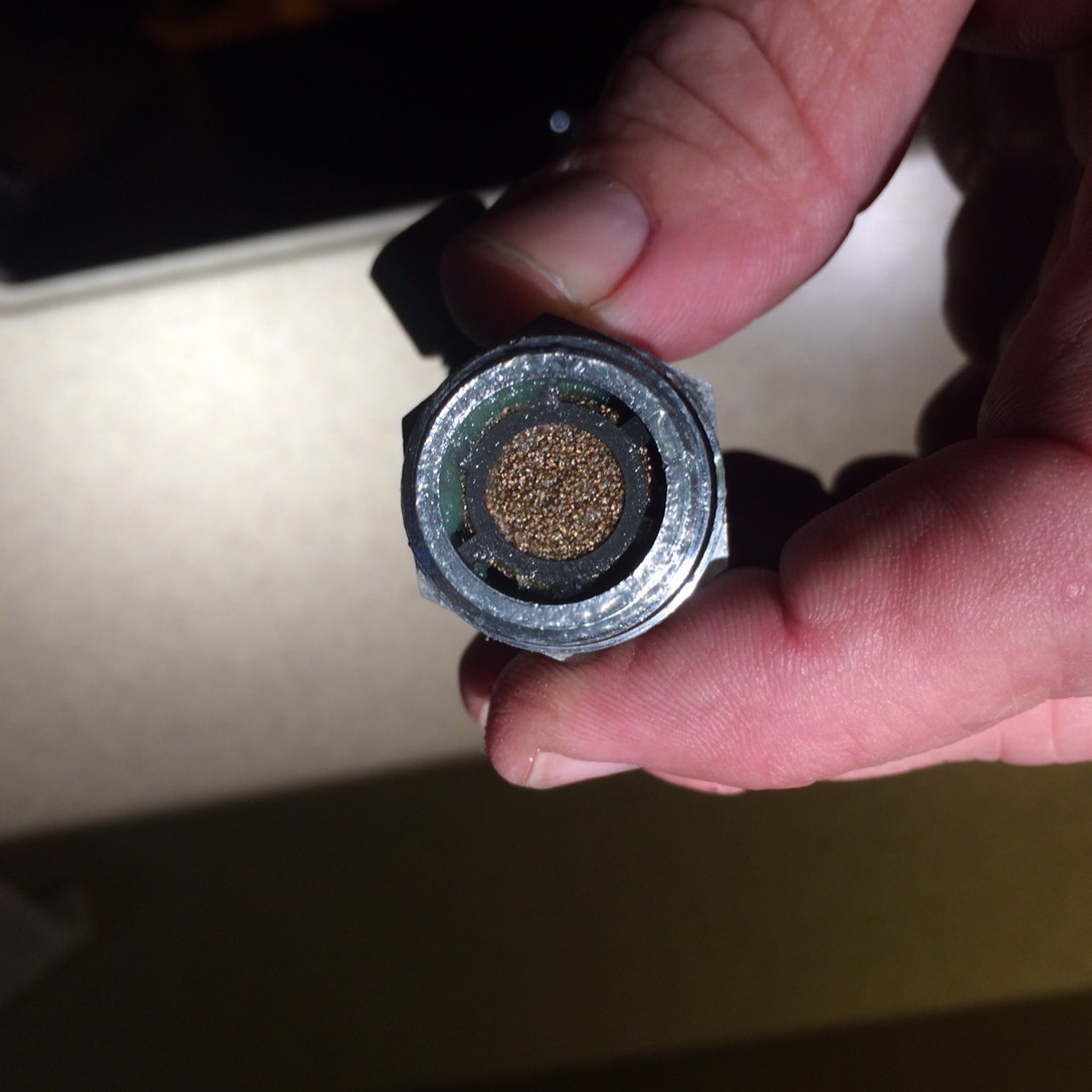

    Here's my latest findings and update,
    Tried one more time to bleed, got nothing but air sooo we started at the source and removed what I call the distribution block thats fed directly from the reservoir and pulled one of the flow control valves. Theres four of control valves with set screws that set the travel of the small plungers in each valve which in turn regulates the amount of flow that goes thru them, at least thats my interpretation. I noticed the small weep holes had some clear debris in them, a couple were plugged entirely so I took the whole assembly apart and cleaned thoroughly. At this point I removed the reservoir and removed the filter element, LOTS of what looked and felt to be silicon deposits (see pics) and that was my ahaa moment, the previous owner / mechanic didn't follow Mfg'rs recommendations to NOT use a ethylene glycol with silicates!! It was so packed you couldn't even blow thru the filter so that explains no fluid up at the bridge or lower bleed valves, I must have bled whatever fluid that was trapped in the system. I spent the better part of the morning cleaning / soaking all the parts which are now ready to re install. The plan is now to flush / bleed the heck out of the entire system with distilled water to hopefully remove any remaining deposits that may have made their way into the system. I cannot say if this is all of the problem yet but it will most certainly help the operation.
    Steve IMG_6515.JPG IMG_6526.JPG IMG_6528.JPG IMG_6553.JPG IMG_6555.JPG IMG_6515.JPG IMG_6526.JPG IMG_6528.JPG IMG_6553.JPG IMG_6555.JPG
