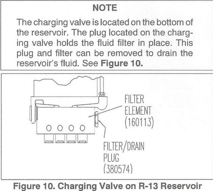

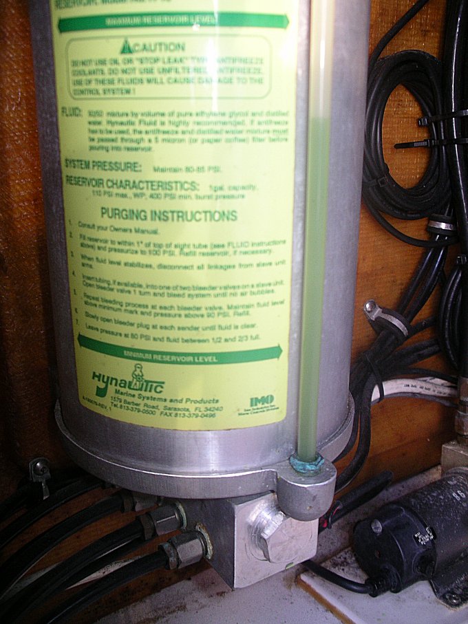

    The only mechanic I've so far found who claims he's very familiar with Hynautic Hydraulic Controls seems to have gone MIA so like a ship at sea with no plumber, the issue of stiff controls has fallen on me. :rolleyes:

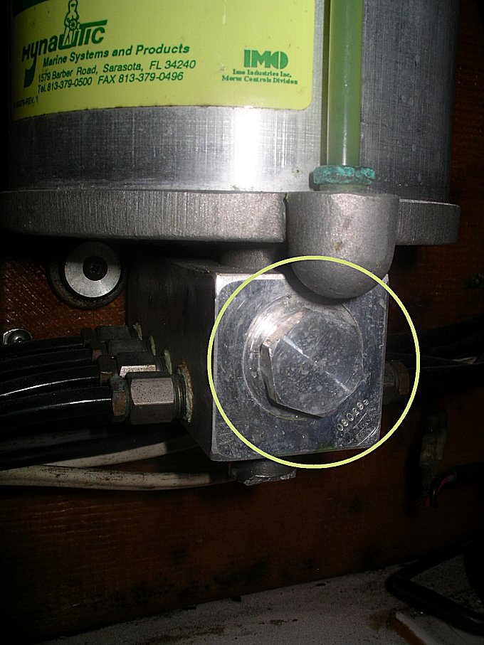

    I believe the fluid is good but until yesterday was of the mindset a little filter in the system may be partially clogged thus creating a partial restriction to the fluid flow. The manual shows where a filter supposed to be located but after letting out all the air pressure and removing the nut/cap discovered there is no filter. Anyone ever mess with this system ?

    The lil filter usually works on the return line.
    I do not recall a filter on the control system.
    I have a few old pubs on this. Please give me a few to find something for you.
    Also, It's cold and even if it is glycol based, it will flow slower.

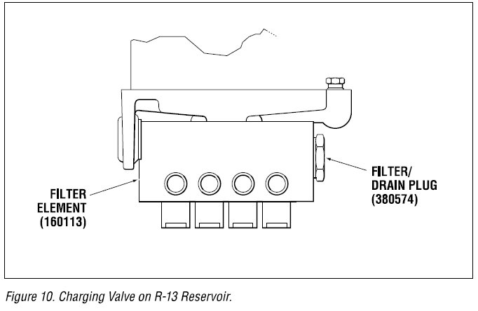

    Here's from the manual showing a filter location where I've none.

    I see your picture is directly from a Dumb-metic manual.
    Not a good start.
    Dumb-metic support and publications can't find their asp with either hand or know where a filter is.
    I'm looking for an older manual when TeleFlex was bending over the Hynautic equipment. This is where this later reservoir/manifold design came from (IMO).

    Just followed up on the other thread you started with. Skippy J may have an idea on the filter (if equipped) is behind that plug and may need some help in removal.

    All I can find in my SeaStar notes is the filter is in the bottom behind that plug.
