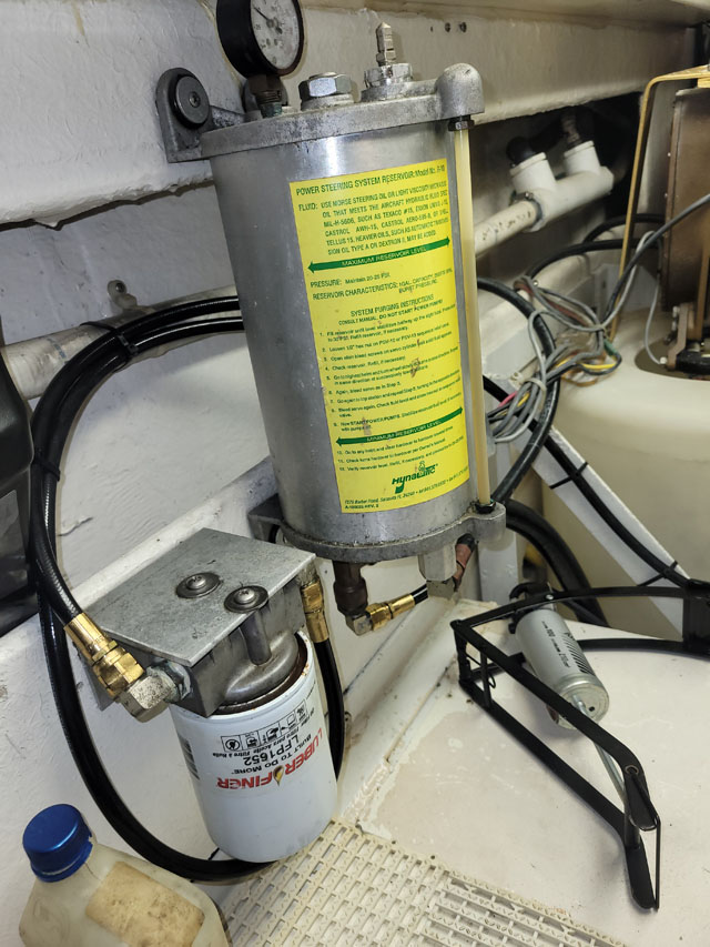

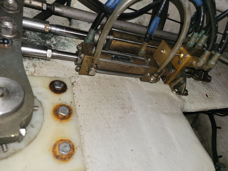

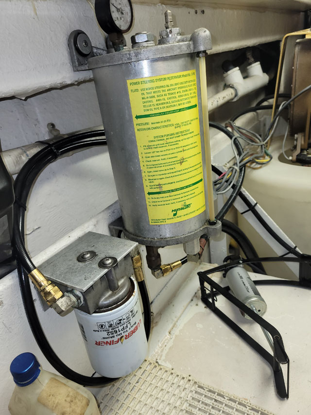

    Working on 52 or 53 ocean with hynatic power steering. The issue being jumping in the steering. Tried multiple times bleeding the sytem with no change.
    The helm pump was replaced last year. The cylinders were supposedly rebuild 3 years ago. The steering will sometimes get better after bleeding but never perfect like it should be.
    I will try to upload pictures tomorrow saying the file is to big

    The jumping it when turning the steering wheel it builds pressure then the rudder jumps. There is not a fluent movement in turning the rudder.
    Also while watching the autopilot you can see it jumping 0-20 sometimes right to 42.
    This boat had a new helmp on it
    Has auto pilot
    Engine driven pump
    Hynatic power steering resivor
    An 2 steering rams
  5. Tylerloom
    Tylerloom New Member
    Oct 2, 2024
    6
    Rhode island
    Sent the pictures. Also I can take more tomorrow. Coming to the forums because never had a issue like this and have struggled with this long. Also asking around locally not much input other then bleed the system. Which I can assure is well bled.

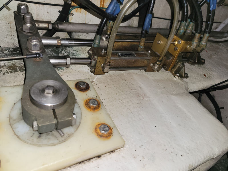

    I was asked to look at it last year I bled it and changed the helm. The issue became a little better with on one point of chattering. An issue is back again.
    The rudder are not binding. I have disconnected both rams and rudder move back an forth very freely. I had same thought originally.

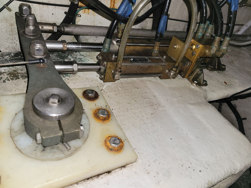

    The old Hynautic power assisted steering (rudder tiller) system;
    When new, properly installed, you could turn the helm wheel with a wet cigarette. This was a sweet system at its time.
    You also had no feed back and hard to feel when the rudder was hard over against the rudder stops.
    Theory of operation first;
    That small cylinder with all those hoses is what your helm is connected to.
    When the helm is turned, it pushes against the rudder tiller. When there is resistance against this ram from the rudder tiller, that lil servo valve is pushed & pulled against.
    This lil servo valve directs pressurized hydraulic fluid to the second (larger) cylinder to assist the helm pressure against the tiller.
    The chatter you are experiencing is this servo valve turning off, on, off, on quickly, pulsating fluid bouncing that larger assist ram like a jack hammer.
    I have witnessed the mounting bolts on this large assist cylinder about to rip out of the rudder pillow because of this chatter.
    Oh, when on auto-pilot, just the constant lil micro AP adjustments would cause a notable vibration thru the boat like a big gatling gun.

    Before you start thinking more about that servo valve, all of the problem is not just there.
    How that valve is dampened is a contributor to the pulsing/chatter issue.
    There were internal & external damping springs. Even rubber bushings experimented with trying to slow down the valve reaction.

    There is 3 ways to fix this.
    1) Spend hours and hours trying different springs in that servo valve and try to dampen its operation.
    If / when this is completed, you will probably loose most of the power assist and have lost some of your finger tips.
    2) Spend lots of bux and purchase the latest fancy steering system. There is a mix of hydraulic and electric models available now.
    3) As I have done a few times now. Shop for a new MSV-21 valve, remove all the power assist stuff, go to a manual system. That larger assist cylinder will now become your primary steering ram.
    The operator may never really feel a difference. Just maybe an extra turn for full port/stb swings.
