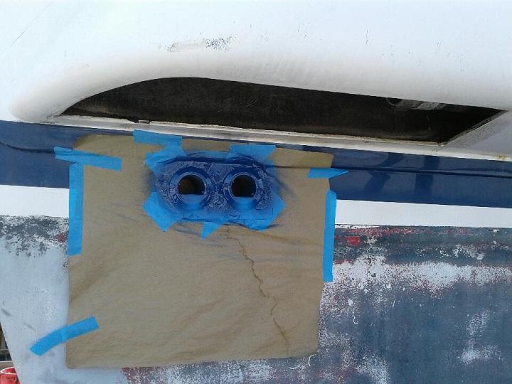

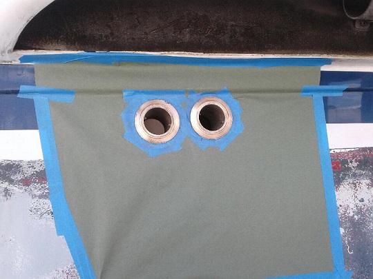

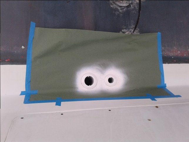

    These new Bronze through hulls were installed then sanded bright , primed with 545 epoxy primer and then top coated with Awl-Grip by using a pre-valve system. As you can see, minimal masking and impact on the surrounding surface by using a medium pre-valve for acceptable results on small areas. Bronze accepts primers and top coats very well when prepped properly.
