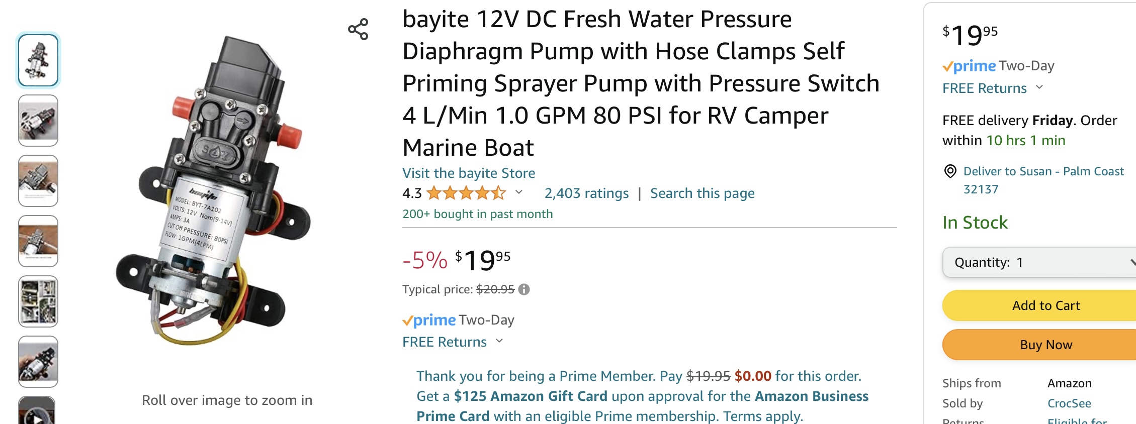

    I had a wet forward bilge, some water from heavy rains and some from the AC dripping condensation.
    Can’t stand stagnant water and smelly bilges so I used a hand pump for a while, then installed a small 12 volt “sump-pump” plumbed into an existing through hull and an ON/OFF switch in the head.
    Used a 3/8” clear hose with a piece on nylon bug screen on the suction side to prevent gunk getting in the pump.
    It worked really well, dry bilges On Demand.
    The little Amazon pump was surprisingly sturdy and kept running dry for 10 hours when I forgot to turn it of one day.
    Had a spare on the boat, just in case..

    That looks like a good deal for a diaphragm pump. Did that one come with clips to connect to a battery or any tubing? Noticed it comes with the clamps.
  17. Norseman
    Norseman Senior Member
    Feb 24, 2005
    3,110
    Nah, no clips, hardwire it to the panel over a breaker, or to the batteries with a fuse.
    Clips are not good on a boat that moves and vibrates, clips be gone and maybe making a short.
    Get used to running wires if you are new to this hobby.:cool:
