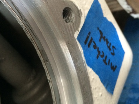

    Isn't one of the issues with the HE service is to check for corrosion on the tanks where the end caps meet the tank? If the tank corrodes you are looking at a pricey repair.
    Is that problem solved on the new CR's? Mine are 2003 vintage.
  15. BoulderGT3
    BoulderGT3 Senior Member
    Jun 19, 2014
    168
    Ftl
    That's the issue. It's $10's of K's but now there are some processes where a machine shop can bore it out and insert a ring so the tank is saved. Mine was ringed.

    I believe that is why Man wants the HE cleaned every couple of years so the o rings don't get over compressed and saltwater start seeping around the o rings causing corrosion. As you mentioned its an expensive repair or replacement. Mine were at 3 yrs but everything was fine. Thanks goodness.

    Mine had to be done in FLorida by MAN. Supposedly
    Mine were sent to Florida in the spring to MAN. They were able to insert the ring and save the tank.
    Supposedly the new ring doesn't corrode like the factory surface of that era.
    Anyone know if this is true? That's what my MAN wrench told me. He says I can go 3 years now.

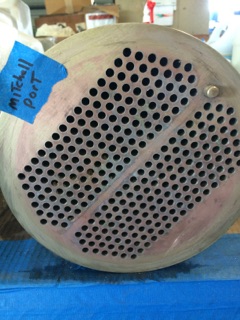

    Here's a picture of the ring. Mine were 3 yrs and had zero corrosion. Your mileage may vary. Mail Attachment.jpeg Mail Attachment 2.jpeg
