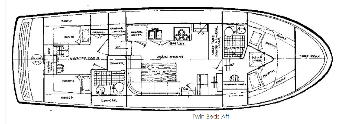

  18. PacBlue
    PacBlue Senior Member
    Jan 9, 2009
    1,994
    Dana Point, Ca
    Looks like a perfect fit, just add some heating:
