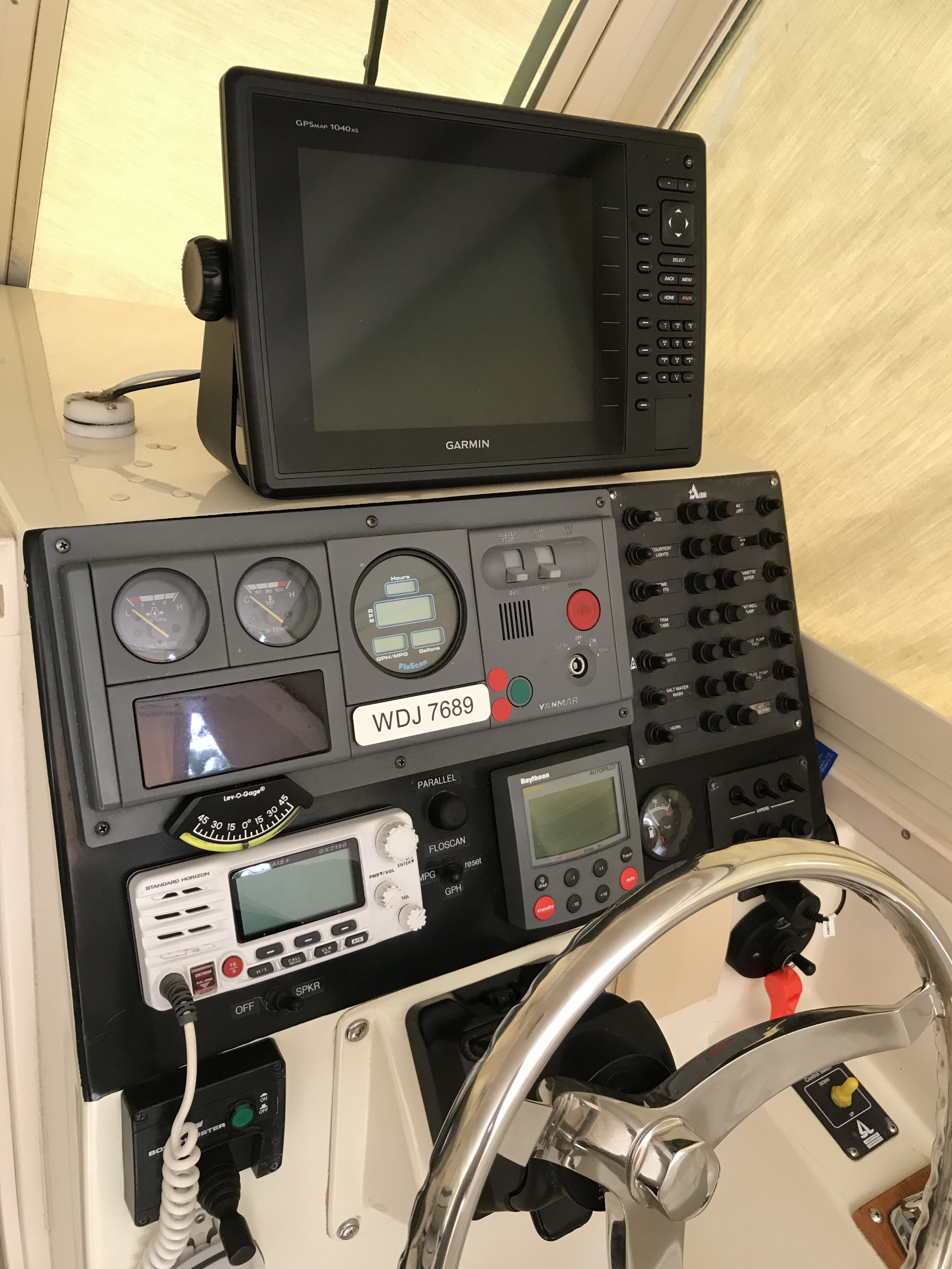

    A pyro gauge has been on my list of things to do for a long time:
    (Yanmar turbo diesel)
    Hate drilling holes and running wires however, also running out of space on the dash for a pyro gauge:
    (Pod mounted to the left of chart plotter perhaps)

  14. Norseman
    Norseman Senior Member
    Feb 24, 2005
    3,110
    Aye Capt Ralph:
    The level gauge is there because my previous boat, a Glacier Bay 2770, coming back from the Bahamas with quartering seas from the Northeast I though the **** thing was going to roll over: Average 15 degrees, max 30 degrees and this was NOT a sailboat.
    For reference I glued a similar Lev-O-Gauge on this here Albin, had no idea a power boat would rock and roll that much.
    Fortunately it did not, hardly see much angle on the gauge, but being an ex-pilot and control freak I need as much info as possible even if running out of panel space.

    If so, maybe Norseman already used the N2k interface to feed the Floscan instrument above the callsign?
  16. Norseman
    Feb 24, 2005
    3,110
    Not sure?
    The boat came with Floscan when I bought her 3.25 years ago and it was installed 2001, when I was just a youngster. :cool:

    I believe the point CaptRaplh was making is that by fitting a N2K sensor you might be able to display EGT directly on the Garmin plotter, with no need to install a dedicated instrument.
  18. Norseman
    Feb 24, 2005
    3,110
    If I could display pyro numbers on the Garmin, great, but would prefer a dedicated gauge. With the lack of panel space I may have to instal a pod:
    But only as a last resort. :D
