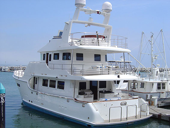

    The first Nordhavn 68 has a hot tub on its flying bridge. Granted the boat is full displacement and three feet longer than your 65 footer, but I doubt your bridge deck would be as high as on the Nordhavn. You could check with Ken Williams (owner) at http://www.nordhavn68.com/aspx/m/Home

    wow, I hope that Nord is like an iceberg, most of it below the water, it looks like a stiff wind would roll it over

    I figured that a picture is worth a thousand words, so here are a couple of pictures of my boat (the N68 that is the topic of this discussion) in 55 knot winds:
    http://tinyurl.com/4cd8doe
    http://tinyurl.com/4v6gts6
    Also check out this video (compare the Nordhavns to the freighters):
    http://tinyurl.com/y8v2tdx
    And, this picture shows the hot tub ready for relaxing near Glacier Bay Alaska:
    http://tinyurl.com/4epm54e
    I am very careful to drain the hot tub before heading to sea, and checked with a naval architect before tackling the Bering Sea. Our boat weighs roughly 120 tons, and much of that weight is below the waterline (twin engines, twin generators, Atlas shorepower system, dual watermakers, etc)
    -Ken Williams
