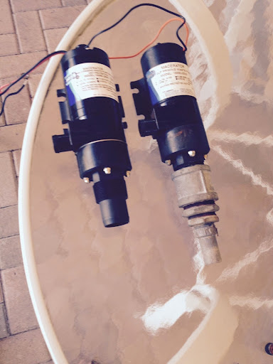

    Been working on a client's boat replacing the macerator pump.
    The inlet to the pump is 1 1/2" but previous owner reduced it down to 1".
    Explained to the owner he needs to "un-reduce" back to 1 1/2" (38 mm) so the pump and the
    system can work as designed.
    He did not think it was a big deal....
    Sooo, I forgot my "hose-math" from Fire Fighter School years ago. How much more volume can a pump suck with a 33% bigger hose? (inside diameter, from 25 mm to 38 mm)

    Ok, math lessons. I don't know pumps but do know math. First, 38 isn't 33% more than 25, it's 52%. Now as area. The area of a 25 mm circle is 491 mm and the area of a 38 mm circle is 1134 mm so it's 131% greater. So it's capable potentially of over 131% more volume. Now in practice it probably won't be that much but it's still a large number and shows how much the smaller hose could be restricting flow.
    Now that doesn't mean it is restricting flow because the power of the pump comes into play. Perhaps the 1" is capable of handling all the macerator can pump. I doubt that though. If the manufacturer designed it with 1 1/2", they obviously felt that was appropriate.

    You want to use the standard 1.5" hose on the intake side as stuff will get clogged in 1" hose, especially with a reducer for stuff to hang up on. Discharge size for the pump you've shown is 1". The Sealand pump is far better but has a 1.5" discharge size also. I would recommend a brand other than the Jabsco one you've shown as they have had a lot of premature failures with that pump. I went through a string of them myself, but everyone else has been saying the same thing. Shurflo makes a direct replacement for that pump that is identical physically.
    There are many ways to do a job the wrong way, and only 1 right way (usually). I will not do a job the wrong way and will tell a customer I'm doing it the right way or not at all.

    I have very little experience working on pumps, but you caught my attention with 1.5" intake and 1" discharge. Couldn't that result in a clog in the pump, and be the reason it was changed?
  7. Capt J
    14,530
    No, the inlet is larger than the outlet size, because the pump has a chopper blade in it and the restriction allows the chopper blade to macerate the stuff.....and the restricted size allows the pump to build pressure to pump it overboard. Jabsco, sureflo, Johnson and another brand utilize this design.....
    OTO, the Sealand brand utilizes a 1.5" inlet and outlet, but uses a diaprahm design.

    The reason for this thread was to find the difference in flow rate or volume from a 1 1/2" hose, to a 1"...Quite a bit and a recepie for a disaster..:eek:

    Picture of New Pump AND Old Pump with Homemade Reduction: :D

    The flow rate isn't the recipe for disaster, the getting raw sewage items to pass through that size hose and getting hung up on the barbed fitting is going to be the recipe for disaster. :eek: I think it would be far better to put an expanded fitting at the tank and run 1.5" hose from the fitting on the tank to the pump. but either way is not right.
