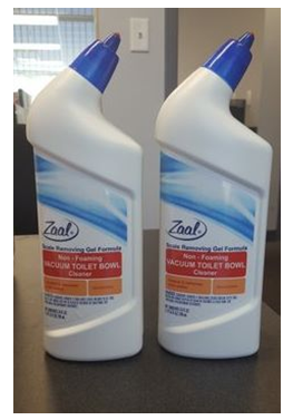

    Yes the Noflex will not break down Uric scale but it works great with smell and sludge and your right only 50 % of the time it will free up the floats .
    You need a different chemistry for uric scale
    Non Foaming, Vacuum Toilet Bowl Cleaner and Scale Remover
    TECHNICAL DATA SHEET Part # FI-ZAA-00-070
    DESCRIPTION:
    It is suitable for use in all Vacuum sanitary and Sewage Treatment Systems and can be used with common materials such as stainless steel, steel, copper, PVC, polyethylene and polypropylene.
    Toilet bowl cleaner is made with a uric scale removing formula to prevent buildup within the vacuum lines with low foaming surfactants and additional anti foaming additives to prevent, any foaming in the lines at the vacuum pump( cavitation ) and foaming on final over board discharge .
    Deep cleaning action of the product for toilet bowls, urinals and surrounding areas eliminates the source of unpleasant odors and provides an improved working environment
    As the gel formula sticks to porcelain surfaces and extends contact time for greater cleaning of the hard surfaces and when flushed the gel sticks to irregular surface areas in the pipe to soften and dissolve scale.
    Product packaged in retail consumer commodity for ease of use and for non-regulated shipping.
    Squirt into the toilet and under the toilet rim, sufficient to coat the area to be cleaned. Leave to soak for several minutes. If needed, scrub with toilet brush. Flush.
    If you are using
    Noflex Digestor.
    Stop use of the Noflex the day before and then a day after cleaning toilet.
    This product will neutralize the Noflex adding it earlier would be a waste of money.
    For larger commercial Noflex auto injection systems volumes treated in piping systems will neutralize any effects before MDS
