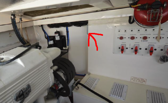

    Bumping an old thread in case it helps anyone. Was searching for info on this for a buddy and the toggle switch to run the macerator (after turning the breaker on) is in the engine compartment. It's just forward of this outlet.
