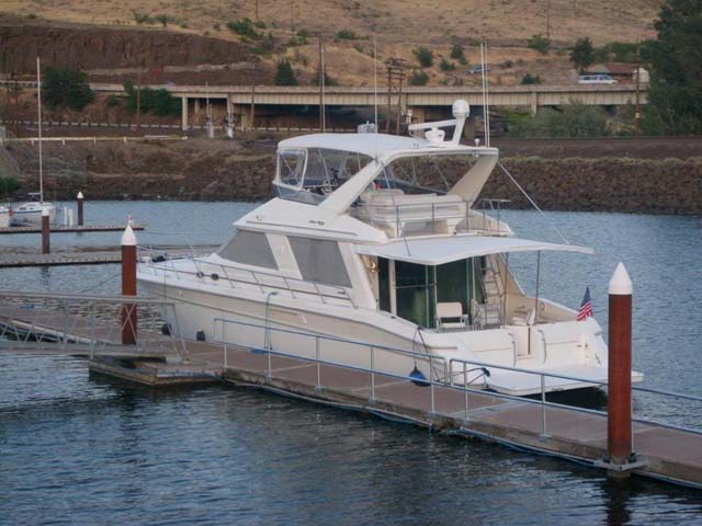

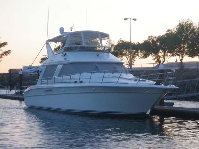

    Is this something like what you're looking for?
    The entire canvas and framing structure can be removed, but we always leave the top in place. We do remove the side and aft windows in the summer and store them at home. The front windows snap up to the top and the windows in the side panels near the front roll up.
    The flybridge canvas and the aft bimini are a material called Stamoid. It's more UV resistant than Sunbrella, and is much easier to keep clean than Sunbrella.
  19. NYCAP123
    11,208
    The plastic looks like strataglass. BTW, you might want to resize those pics.
