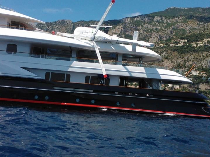

    Looks like the Eurocopter of Attessa IV. They must have encountered some heavy weather. Expensive but most likely not beyond repair. One more argument for placing a helo in a hangar. Seastate can be counteracted with proper tiedown. But seastate plus heavy wind can break the toughest rope. At least not an landing accident where somebody got injured.
    Unless your fold down seafence is for a ship with permanent helo operation, with many T/O and landings a day, I would go for manually folding rails. May be remotly operated by crank or lever (for crew safety) but no hydraulics. We had one case, where a hydraulically operated segment of the helipad rail came partially up due to residual pressure in the system and a failed valve. The skid gear of the helo got caught by the rail during T/O and only the lightning fast reaction of the pilot prevented a deadly accident.
