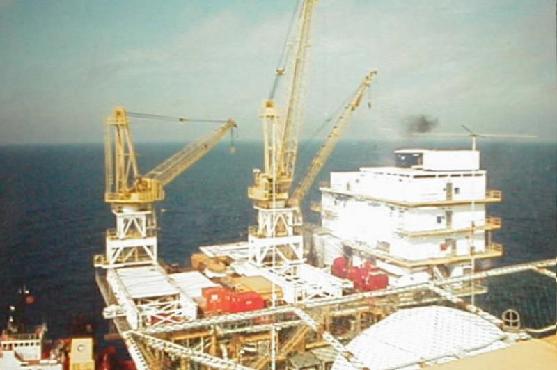

    Define Landing....
    Depends on what and how it is used. But I would get some baseline Yacht related data as to what has been allowed by the insurance companies. Preferably not directly from them.
    Structure is the easy part. Complete Operating instructions, ground crew training, etc get to be important quickly.
    Most of my direct experience is in Offshore platforms of various types, with guidelines from the API and State of Louisiana and ABS. But I have done some logging and other temporary design work as well.
