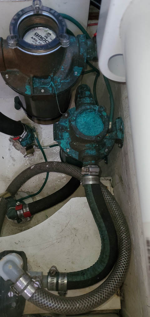

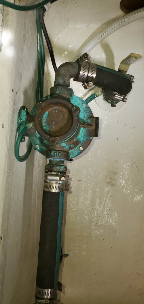

    Does anybody have any ideas or product suggestions for getting rid of heavy brass tarnish, buildup, and corrosion? Structurally there is no damage but it's unsightly. See attached photos.

    11,208
    Noxon to clean it, then coat it with at least CRC or naval jelly but I like Boeshield T9.
  3. Capt J
    14,530
    The bronze turns green to protect itself. If you insist making it shiny again, something like the above or an acid will turn it bronze color again. best way to protect is to spray with with a rattle can clear coat, krylon makes a good one.
  4. Capt Ralph
    13,439
    That is not Heavy Brass Tarnish and Corrosion, Think of it as Patina.
    Some folk pay extra for that.
    Brush on some On-Off gell and hos it off in an hour.
    Do not inhale the fumes.
    The equipment will look gold then. When dry, spray with a clear coat.
    Or, let it go and age properly.

    ver·di·gris
    /ˈvərdəˌɡrēs/
    noun
    1. a bright bluish-green encrustation or patina formed on copper or brass by atmospheric oxidation, consisting of basic copper carbonate.

    It won't hurt but I agree it looks shoddy. Looking at those picks again I think I'd just put a little Vaseline on a wire brush and brush it off. I don't think you're looking to make them mega-yacht bright, just looking good. The Vaseline will coat as you go. No need to use a sealer. Just brush it off with Vaseline as it appears.

    You got it exactly! Vaseline on a wire brush may be just the ticket.

    Hey NYCAP, Got some Vaseline and a wire brush and it worked like a charm cleaning the corrosion on the bronze. Thanks for the tip!!
