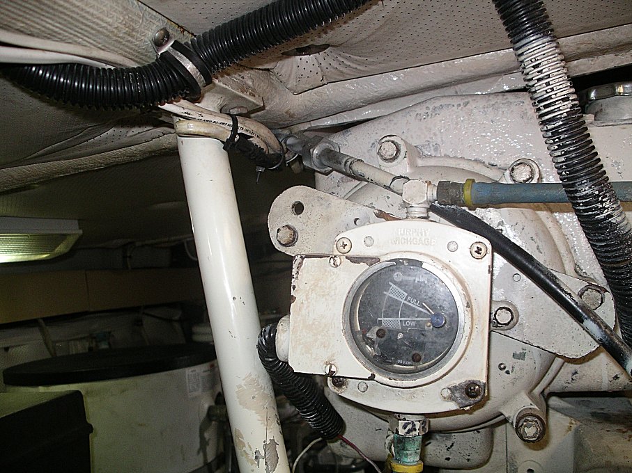

    Recently discovered a pair of these gauges on the 820 hp. Man's. Appears they each have a small micro-switch inside their lenses but for what ??
  2. Capt Ralph
    13,436
    An alarm.
    Are these the Murphy Gauges we were talking about on another thread?

    Yup, low level alarm is indeed the most reasonable guess.
    Interestingly, such alarm is already included as standard in my 800hp V8 - even if MAN didn't include any level gauge, natively.
    So, I would have thought it should be there also in your 820hp V10, albeit a bit older.
    Haven't you got a low coolant level light in your dashboard, together with low oil pressure etc.?

    It looks like "Murphy Switchgage" (whatever that means) is written above the lens.

    YES, but the other thread was closed and I did not see any microswitch in the the posted photo of the gauge on the other thread. My dash is currently a massive clump of wires till the new dipped carbon fiber panels arrive so not able to do any testing yet but a low HE alarm would be great as unless two salon floor sections are removed, can't even check the water so do need to test these alarms. I know some of the old warning lights were blown-out bulbs; all of which will be replaced with LED's when installing the new panels. Only have about an inch from caps to ceiling but I guess that's the "price" for the extra hp. vs. what I believe was the, back then, standard Detroit's.
    A review of the purchase survey noticed it recommended adding over flow tanks but for some reason it appears Man doesn't use them.

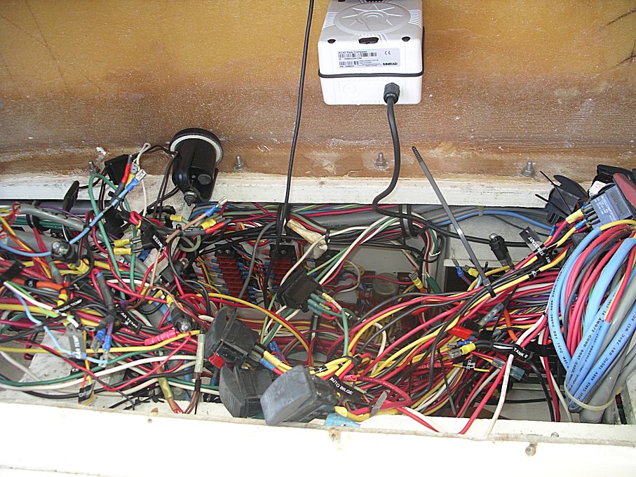

    I recall only water temp gauges but there were a bunch of various alarm lights. I dare not put my hands on the birds nest of wires & switches the tech doing the project up there left while we're awaiting new panels, gauges, switches, LED's, even though he of course labeled and wire tied them.

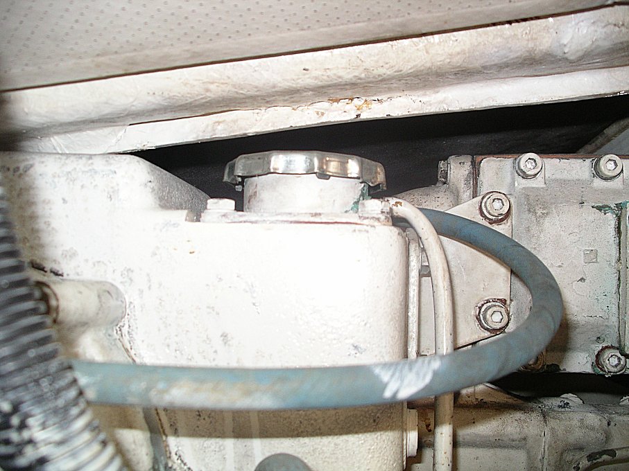

    It shows you the coolant level at a glance since the heat exchanger cap is so close to the ER ceiling. It also does look like wires come off of them for an alarm function as well. I remember someone in the other thread being very adamant about these gauges hardly ever being used.
