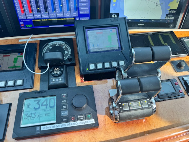

    I m now pretty sure it was the pilot house control that was causing the issue. I removed both aft deck controls and while it ran fine on the first test, the issue returned after that
    next I disconnected the pilot house control and temporary hooked up one of the aft deck control and so far so good. 4 runs without errors, well beside the system freaking out because two sets of controls are disconnected :).
    keeping my fingers crossed.

    Oh, The ole Rexroth controls.
    I had assumed the later TD controls.
    I have fried lots of brain cell chasing MAN issues with these controls.
    Unlike the TD (commander) heads subject from weather issues, these are better but subject to inter connect issues.
    If you rotate the control head off to/from another location, The problem mat return here.
  8. Capt Ralph
    14,207
    That's a lot of stuff on that dash.
