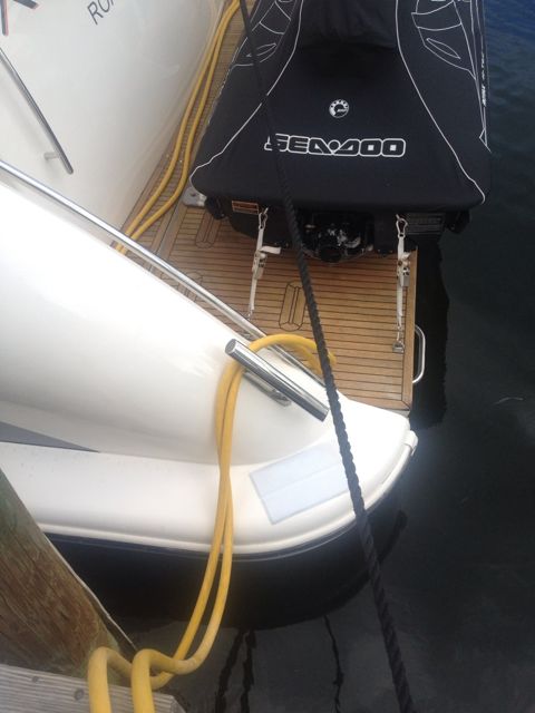

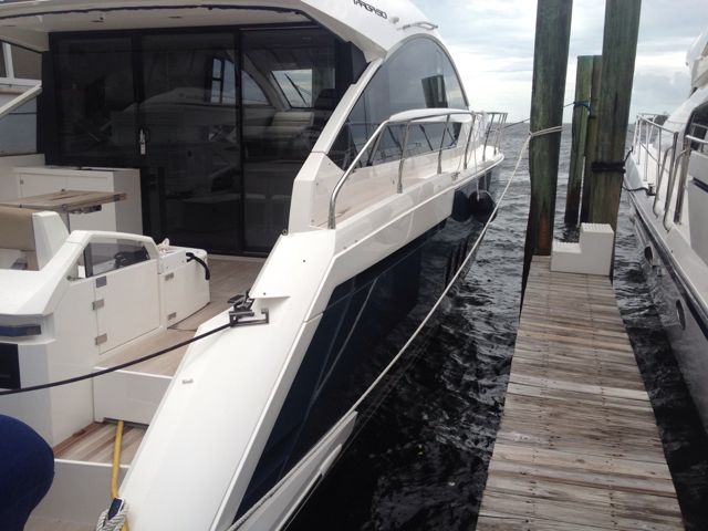

    There is also this beauty...
    It has a 6 foot section of hull totally unprotected (rub rails are just so unsightly...) and no boarding gate in the railing so you have to climb over... Then if you look carefully you ll see that if you need to set a spring line far aft the line will be rubbing on the gel coat due to cleat placement...
    And hard to see in this picture but the forward section of the railing extends outward beyond the railing. I guess the designers have never needed to pivot off a piling!
    Nice job FairlIne!

    We'll it could get scuffed depending on how long the boat's tied there that way. I often see them putting a soft 'sheath' (not sure what the correct name is) around the mooring line or fender line that will rest on the yacht's painted finished surface. Maybe if they did that, it might not have been that big of a deal.
  7. Pascal
    8,163
    Isn't it a lot easier to put the cleats and chocks in the right place?

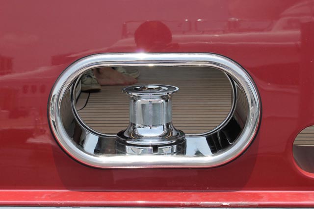

    Here's one of MANY additions I could make. The picture speaks for itself...

    Point taken but I was just suggesting what I see being done in the cases where improvisation is needed.

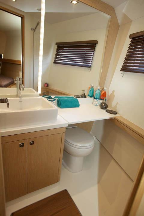

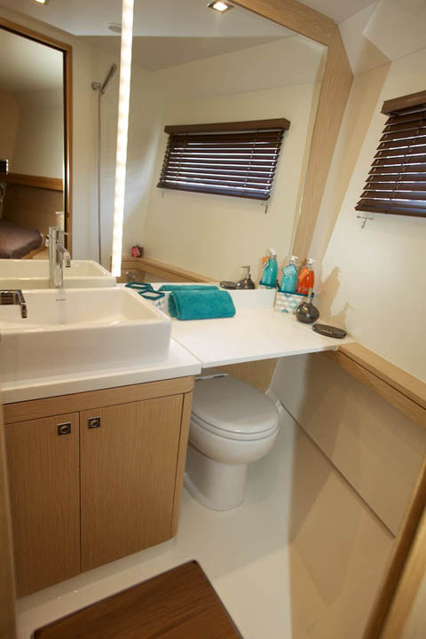

    Improvise this, while enjoying Montezuma's Revenge - tic toc tic toc
    Here's one that begs the question, "What were they thinking?"

    I saw that too. What is the one thing that gets used more times a day in a bathroom? Stupid.

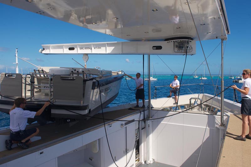

    The foredeck crane for the tender on Big Fish it still one of the most ridiculous things I've ever seen on a boat.

    If the hydraulics fail on that, crunch and splosh!!

    That setup is pretty ingenious actually, except that those hydraulic rams should have been another foot longer for the tender to clear the deck

    Looks familiar, that's on the Le Trawler by Garcia Yachting in the review we recently did. I wondered the same thing when I was reading the review.

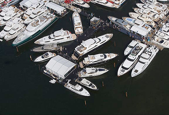

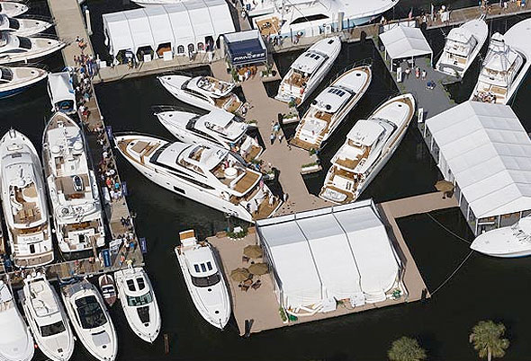

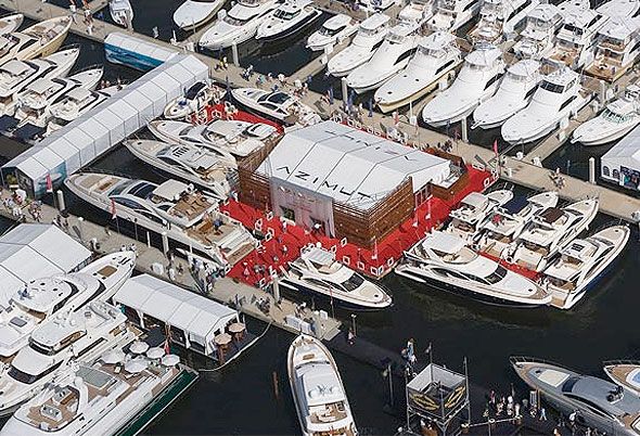

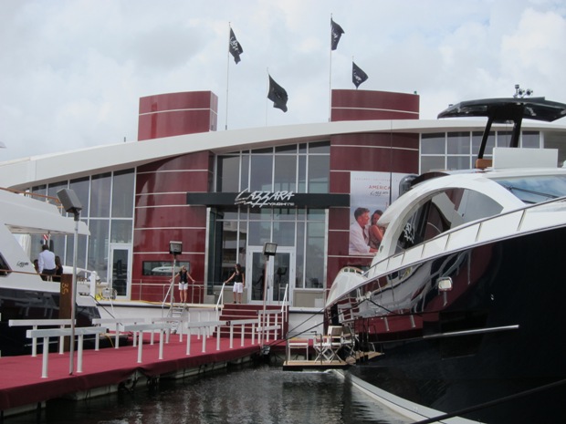

    Actually I think builders like Azimut, Princess, and Sunseeker expect folks to board their boats stern to Med style like you see here in pics of their displays at last year's FLIBS from the Showmanagement website
    Since their vessels are displayed this way at shows in the water and on land it probably never occurs to the uninitiated to think of boarding any other way until they are faced with the situation for the first time after purchase.
    Lazzara's display is setup in the same fashion.
