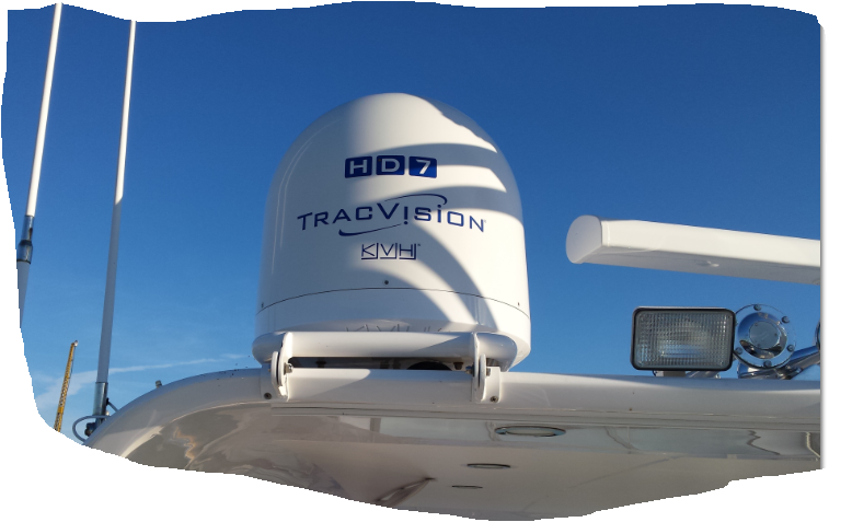

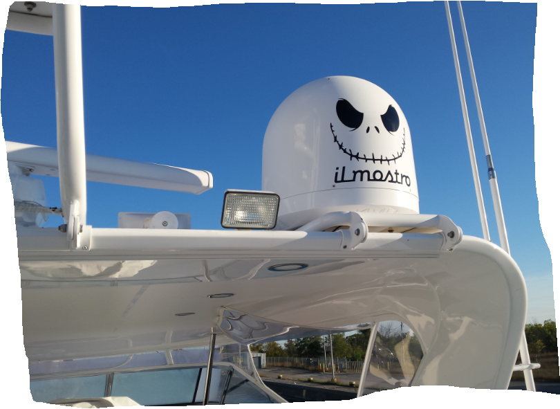

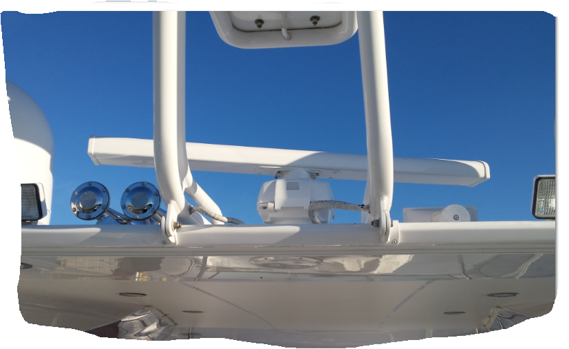

    On the Erie Canal just because you make it under a few bridges don't assume that you will make it under the rest of them, last year two yachts I helped through the Welland Canal both yachts struck a bridge on the Oswego Canal, one boat damaged his radar and the other hit his dome, in both cases the water pool level was above operating level.
    The pictures below is a 85' Pacific Marner that I take through the Welland Canal twice a year had both domes and radar arch put on a hinge and it only takes a few minutes to lower them, as she comes north every year she was made this way when new at the factory for the Erie Canal.
    Some of the bigger yachts I take through the canal will spend a few days taking down arches and domes just to avoid going up the St. Lawrence River.
