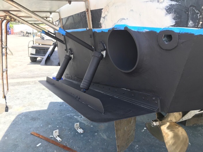

    Mechanically in addition to the Cummins C series repower (with new nibral props, one piece shafts and new exhaust) I have re wired the whole boat converting the house DC to 24 v. Some of the 1970 wiring I ripped out was downright scary ... not a single wire has been kept. New electrical panel as well. The only component of the electrical system I kept was a 2002 Norpro 18kW generator. New larger trim tabs have been installed to provide more lift. The boat can cruise 17kts and tops at 20kts

    You used 450hp Cummins for your repower and get a 17KT cruise. What HP would you guess it would take to get a 20KT cruise? Great work on your 53 !
  10. Pascal
    8,164
    I m not sure... I guess 500hp. The large fins probably cost 3/4 kt
    i really think the larger trim tabs and weight reduction help get boat on plane and lift the stern to a better running angle. I ll have to get some drone or tender video of the boat getting on plane but it doesn’t feel like the stern dig in as much as I ve see with other hatts. Since my boat had naturals I don’t have any reference point as she couldn’t get on plane before.
    I forgot the size of the original trim tabs. The new ones are 54x12. I also glasses the original cavity under the hull where the old trim tabs where and mounted them conventionally on the transom edge.

  14. Capt J
    14,435
    550 HP or larger trim tabs.
  15. Capt Ralph
    12,741
    For the money and expected cruising speed for the bux, Pascal did great.
    If you need 20 kts and continued operation there. the Cunnins 8.3 would be great. Different tunes up to 600 hp.
    However, IMO 16-17 kts is probably the best speed for that hull. You would get minimal returns on just pouring fuel in to find 20kts in any engine.
    Open a new thread; Give us some ideas at what your really looking at / for..

  17. Capt J
    14,435
    While I agree with this, I ran a 58' Yachtfish for a lot of years. It cruised at 14-15 knots. At WOT it did 21 knots and the ride was much much better at 21 knots. Cruising at 20-21 knots would be much more stable in a beam or following sea IMO.
