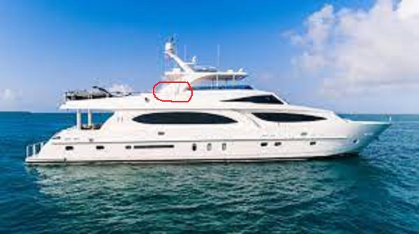

    The fly-bridge hard top. Aft supports are glassed to the coming. Always cracks here.

    Yikes. That is good to know. Once repaired is it an ongoing issue?
  4. Capt Ralph
    14,563
    I'm sure cosmetic, just to me an eye sore.
    I noted that on a couple of boats that I was assisting on during deliveries years ago. One was supposed to have been fix already and it was coming back.
    Now that I'm looking back, That was over 10 years ago, on now 11 to 13 year old boats. I have not been on one or in that group since.
    I remember saw dust and wood crumbs piled up behind the water heater, under a port staircase, on a supposed boat show ready boat. Been there since build, Ha.
    But that was it, Sweet ships, rode, responded all well.

    I regularly run a Capri Skylounge (94') built in 2006, and it's as solid as a boat that I have ran. Good cruise and with a great fuel capacity, it just goes. I have never noticed anything cracking on the hardtop supports, but its a Freshwater Boat and has been for the last 12-13 years, and she goes to heated storage every October.

    Are they gel coat? I thought they were painted.
  9. YachtForums
    20,947
    Ralph mentioned cracks in the combing. Assumed it was gel. Maybe not?
  10. Pascal
    8,944
    Gel coat cracks will show thru the paint…
  11. Capt Ralph
    14,563
    I could not tell you if it was originally gell or paint. That repair probably was paint. I would think they have fixed that issue and figured how to fix the older boats with that problem. There were other hardtop designs that did not have this issue. I thought then it was because more of the top was supported keeping it from twisting on every roll. Lil vertical support pipes forward could only do so much.
