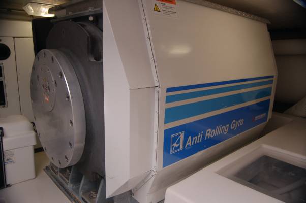

    Can't say I used them, but doing a review of a 70-foot Bertram for an article, this baby had two Mitsubishi ARG boxes installed in the aft engine room area. I was told that Bertram is making this an option on all new yachts, and building in the mounting pad during construction even if you don't order the gyro when new.
    Rep for imstall/tech company specified that they should reduce roll by about 50% or so. Mitsubishi had an eclusive with Ferretti, but was told that it either lapsed or was to do so soon (told this a couple months ago). Didn't get a chance to turn it on during my sea trial. Box is maintenance free and you flick a switch to turn on, but it can take 20 minutes or so to get up to full rpm. Don't have my notes handy right now otherwise I would give a few more specs. Definitley would like to try it and may call Bertram to get a demo for an article.
    Here's a shot of one of the two on the 70.

    Thanks Tom, it looks quite a big lump!
